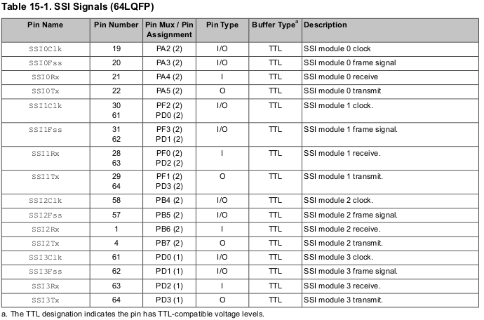

However when i try to run this I end up in `FaultISR()` When I call `GPIOPinConfigure()` on a pin that has already been configured. Do i need to do a reconfigure or something?

  • I will bet my launchpad shirt that the SS1 and SS3 don't share the same pins!
    Could you please take a picture of said card?
    If you check the datasheet and this handy Energia pin out you will see that there aren't any shared pins between SSI
    energia.nu/.../tm4c123pinmap.png
    Anyway, even if that holds true, like cb1 said, do you really need to do that? Couldn't you just use other SSI?

  • The SD Card and Screen share a breakout so they share MOSI, MISO and SCK lines. So using two SPI interfaces which share wires or with a modifiable CS line is preferable.
    I am lookingat this document which came with my board. And youll notice SSI1 and SSI3 share some pins. (Highlighted)
  • Ah yes Jordy but notice, I think it's better seen in the datasheet:
    The SSI1 has multiple choices of pins! See now?
    Btw, if you see in that paper there are some pins that have to GPIO there correct? You know why? PB7 is shorted with PD1 and PB6 is shorted with PD0 through 0-ohm resistors. If you want to use PB7 and PD1 or PB6 and PD0 at the same time, you will have to remove those resistors. Just a consideration for the future.

  • cb1- said:
    It must be then - that SSI_1 & SSI_3 are duplicated - upon (other) Ports/Pins - w/in your MCU.
    Good response - (now) I've checked - and the statement I made earlier (quoted) is correct.    Note that SSI_1 appears across two different Ports - SSI_3 only one!
    Now - after reading your response - I can sense (some) advantage in your "switching" SSI peripherals - across the same pins.   Should each remote SPI device require different SPI data format - or clock rate - that could provide an advantage.
    But there's a, "fly in that ointment!"   By simply switching to a 2nd SPI peripheral - which attaches to the exact same MCU pins - how do you "fully/completely" de-activate or tri-state the "disabled" SPI peripheral?   That's required to prevent MCU peripheral contention - is it not?    Plus - the relative "rarity" of having 2 independent peripherals - share the same MCU pins - calls into question the skills & testing expertise required - to insure - that this (rare) method will work properly - under "all" conditions.    Is that clear.
    So - believe that explains your landing in the Fault ISR, "condition."    (although - if official boards exist - and "sanction this shared pin rarity" you (and I) may have "missed some detail."
    In the absence of (your) discovering & then complying with such detail(s) - I'd bet this would work by your full "Disabling" of the SPI port not in current use.   A call to function (similar to) SPI Port_x Disable may work.   (but you should probe the MCU's pins - both before & after - to insure that "residual SPI values/levels" do not persist!
    A surer method would be to both disable the previously enabled SPI port - then reset that peripheral (keeping it disabled) and then "Reconfigure the "new - now desired to function" SPI Port.   Such "pin sharing across peripherals" saves pins - but eats time/effort/money - I'd not go that route...
    [edit: just now saw Luis' response re those (delightful, so considerate) "PLAGUE 0Ω Rs!"    Indeed they'll (almost surely) wreck expected use of PD0/PD1!    Gotta go.   That said - your opening post (almost) suggested that you got ONE SPI periph. to work.   Method I've detailed here - should insure they both work - but only if you comply w/these rules - and use one at a time - and kill those idiot Rs.
