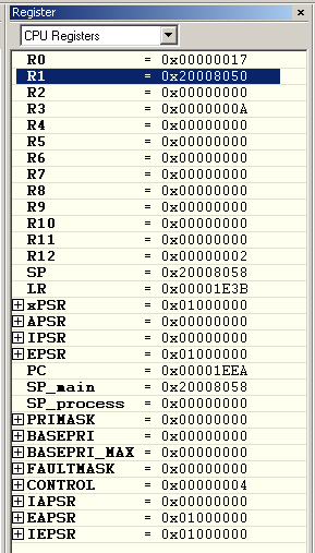

    This thread https://e2e.ti.com/support/microcontrollers/hercules/f/312/p/287534/1004618#pi239031349=2 contains IAR screen shots for a LX4F Stellaris MCU which show the Cycle Counter in the CPU Registers view.
    However, using the free IAR KickStart v7.40.1.8472 with a TM4C1294NCPDT the CPU Registers view isn't showing the Cycle Counter:

  • cb1- said:
    Now we always (and only) connect to ARM MCUs via our J-Links - and that via (again only) SWD.     (doubtful that SWD aids - but J-Link may)
    My previous screen-shots without the Cycle Counter were made when the IAR KickStart was connecting to a TMC129 device using the Stellaris-ICDI.

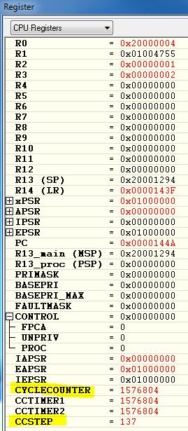

    When I connected to the same device with a J-Link (via JTAG) then the Cycle Counter was shown in the CPU Registers view and was enabled:
    So, you are correct in that the IAR use of the Cycle Counter depends upon the debug probe used.

    I found past screen shot which I had posted here - it very much agrees w/yours - so this is not confined to, "paid" version.
    Do note that "CC Step" bottom row - its the one which reveals the cycle burden of an individual function.     We first "break" upon entry to the function - and then break again upon exit.    CC Step value reveals the cycle burden of the target function...  (did I say, its "fully AUTOMATIC!")
