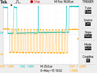

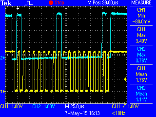

    Thank you for your suggestions.
    I did the suggested modifications and few more after seeing some examples.
    1) I have changed the pull up registers from 10kOhm to 4.7kOhm, because Vcc is 3.3 V (taken from TIVA C) so with 10kOhm voltage at SCL and SDA pin comes 1.8V and min voltage specified by the PCF8574 is 2.5V.
    2) Commented the HWREG statement.
    Below is the wave form I am getting.
    As per the main circuit schematic I need to put 0(zero) to make the LED glow. But Pin P0 on PCF8574 never goes down.
    I have tried it with burst command also but result remains the same. Please let me know if I am missing something.
    Below is my code;
    May I observe that (something) is rotten with the result I've highlighted, above.      Is something else (unexpected) upon your I2C bus?     That great a change in voltage is abnormal - I'm wondering if your "read" of 10K was incorrect.     (100K, mistakenly installed - may explain)
    Have you (recently) measured the operating voltage @ your remote device's power pin?      And is ground properly routed between your MCU board - and your remote slave?
    Will leave that delightful "gob of code" to more motivated others.      Again "loopback" seems both unnecessary and a potential hindrance to your "live remote device" application - glad that you've eliminated it.     (you may check to insure that's (really) the case...)
  • Hello Anupsingh,
    Please check the slave address you are using. If you see in the waveform (Scope snpshot) the address is being NAK-ed.
    Amit
  • Hi Amit,
    Might you (briefly) comment upon the (abnormal) drop reported while 10K pull-ups were employed?     We've used 10K for years - especially when battery powered - and consumption is an issue.    Iirc - Philips (I2C originator) spec does include 10K - does it not?
    Even a (horrible) slave address is unlikely to account for so drastic a voltage drop....

  • Hello cb1,
    I am not very clear with it so was waiting for an answer to your question first. With a 10K resistor the voltage should have dropped all the way to 0 and come up to 3.3V. With a stronger resistor it is the low level voltage that would be affected.
    Amit

    Thank you for your suggestions. I have verified it and it was 10k only.
    As per your suggestions I have ohm out the connections and it was okay.
    In below post I have seen that the wave forms are coming with 1.8V only and the user has kept 10k only.
    https://e2e.ti.com/support/microcontrollers/tiva_arm/f/908/t/364191
  • Hello Amit,
    Thank you for your suggestions. Yes I was making a mistake. The address should be 0x20 not 0x40 (which I was writing).
    The code is working now.
    But I am still confuse how to interpret 7 bit hexadecimal value. After referring some literature I got this 0x20 .
    Below is the wave form coming now.
  • Hello Anupsingh,
    The address is represented in 5 downto 0 format. But when packing it up for a byte it must be 8 bits. Secondly some data sheets show the R/W bit also as part of the address, Hence what is seen as 0x40 is actually 0x20.
    Amit
