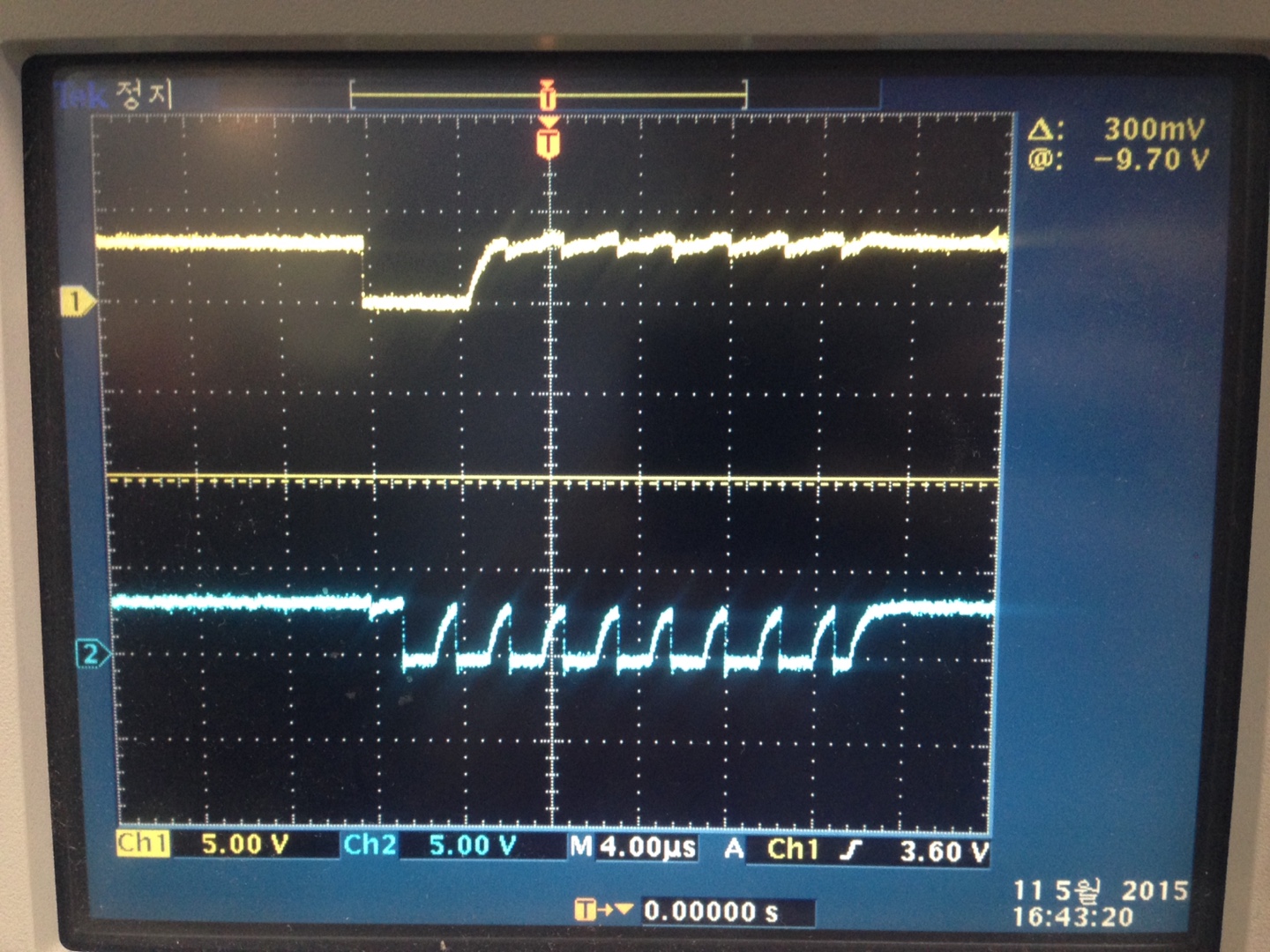

I2C question between TCA6416A and TM4C129DB board
Other Parts Discussed in Thread: TCA6416A, TCA6507
Subjet: I2C  question between TCA6416A and  TM4C129DB board
I am using to TCA6416A and  TM4C129DB board , but I2C_MASTER_ERR_ARB_LOST is generated by I2CMasterErr(ulI2CBase).
help me !

  • Debuf Message :
    I2C Address:20
    I2C mater->slave : 2
    transferring 1-> I2C command writing.:0x2, busy return value:1
    I2C transferring 1-> error valu: 10
    I2C transferring fail...
    I2C Address:20
    Hello Amit.
    I remove GPIOPadConfigSet(GPIO_PORTB_BASE, GPIO_PIN_2 | GPIO_PIN_3,GPIO_STRENGTH_2MA,GPIO_PIN_TYPE_OD ); . so I send uppper result.
    and  change from 4.7K to 10K register.
    if you  send   email to me . I will send  IAR project file .
    thank you ..
    from Jaehyoung Lee
  • Hello Jae,
    The waveform does not make sense
    1. The address is 0x20 but the SDA shows 0x1F.
    2. Can you add the delay loop of SysCtlDelay(100) before polling for I2CMasterBusy.
    Amit
