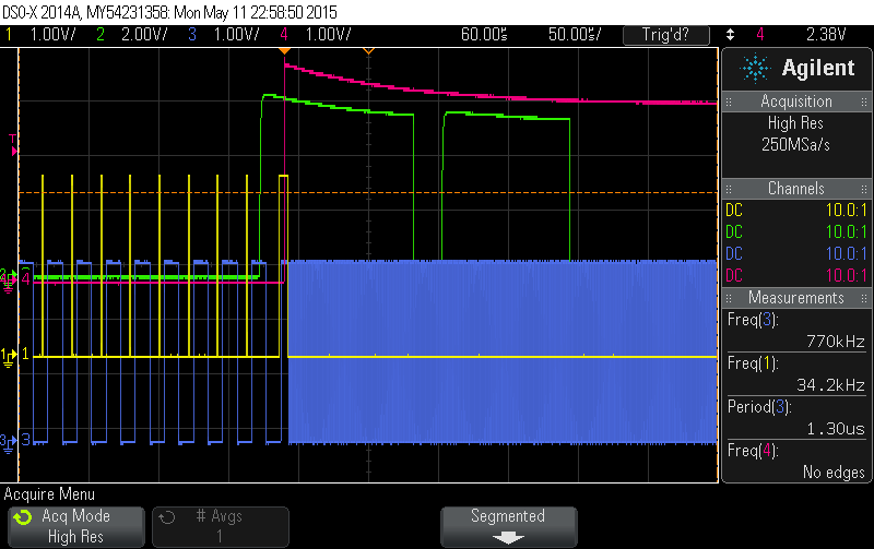

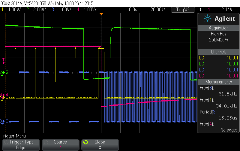

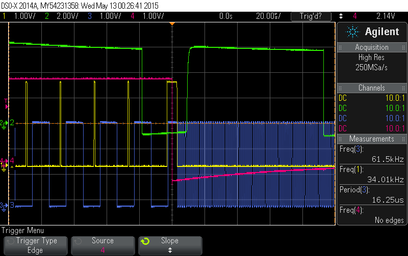

To illustrate this issue here below there is one of many correct conversions + UDP sending at the same time:
  • Green line is a GPIOoutput triggered inside lwIPHostTimerHandler when every udp frame is sent
  • Pink is when the ADC interrupt  for that specific phase is thrown.
  • Blue is an ADC conversion timer

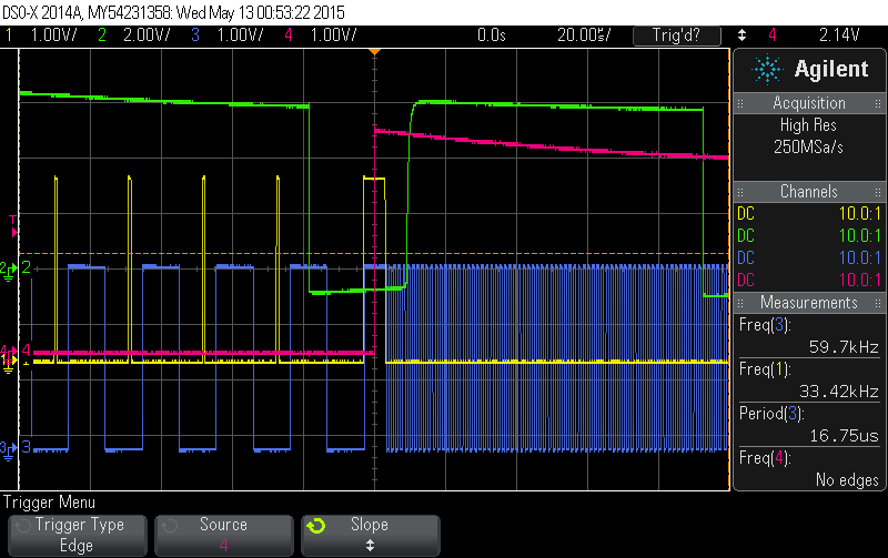

And this is when there is an error and ADC stops:
Again,
  • Pink is a GPIO toggled when the ADC interrupt  for that specific phase is thrown.
  • Yellow is a GPIO inside the toggled inside the ADC interrupt for every sample (as you can see it stops!!)

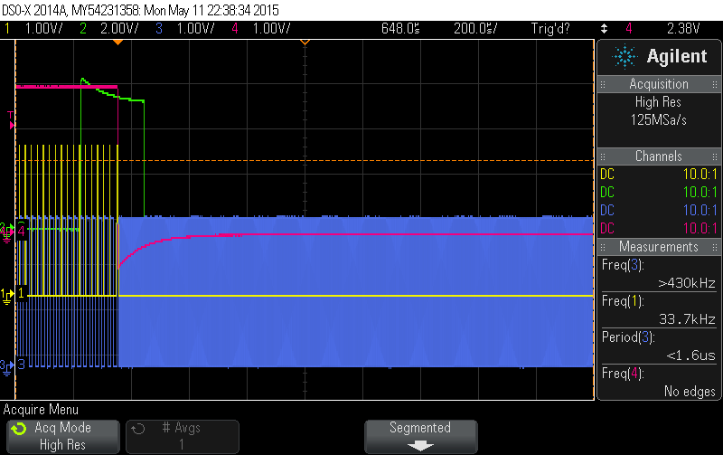

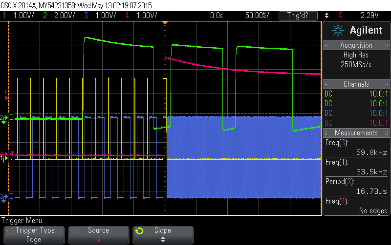

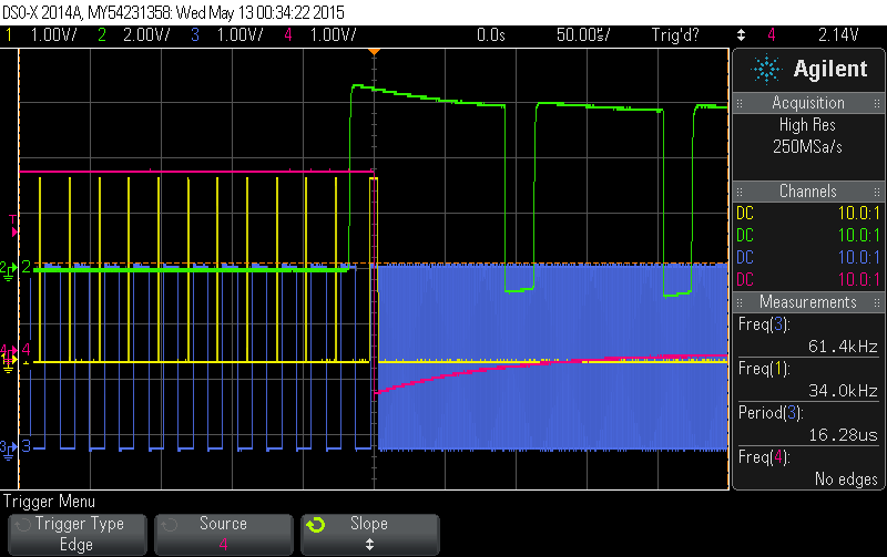

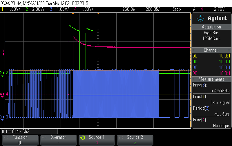

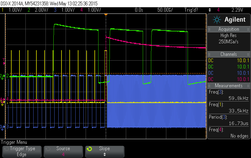

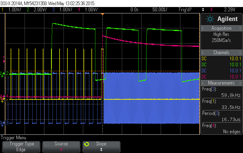

It happens very often that when the ADC get stuck, the sending of the udp is at the very few samples of the ADC conversion (masking?).
But it is not excluvely in the last sample. For example take a look at this other error sequence:

  • To illustrate the relation between EMAC and the stop of the ADC converter, here below, there are attached many cases of the last interrupt of the ADC.
    As you will see, the issue appears when an lwIPHostTimerHandler happens in the last clock of the ADC conversion.
    As previously:
    • Green line is a GPIOoutput triggered inside lwIPHostTimerHandler when every udp frame is sent (sending three now)
    And inside LwipHostTimerHandler:

  • Hello PAk,
    The EMAC is working with the SysTick Timer Interrupt which has higher priority than other Interrupts
    By disabling EMAC from the code you are changing the delay processing of the CPU to the ADC Interrupt Handler.. That is why I am suggesting the first approach to check it with the ADC Sequencer Disable-reconfigure-Enable. If that does not work then move to averaging in software.

  • Could be a Heisenbug PAk, the description certainly sounds timing sensitive.
    Robert
  • Adding
    ROM_ADCSequenceDisable(ADC0_BASE, ADC_SEQUENCER);
    ROM_ADCHardwareOversampleConfigure(ADC0_BASE, 0);
    ROM_ADCSequenceEnable(ADC0_BASE, ADC_SEQUENCER);
    did not help.
    I still don't see the point why it only fails with 16 samples averaged and not 8 or less.
  • Hello PAk,
    OK, that rules out the fact that a change can be performed by disabling the Sequencer for the hardware averaging logic. My suspicion still relates the averaging block with the fact that a value of 16 gives it a rather large window to operate for failure. Some experiments need to be done on my side but will take time.
    Amit
  • Thank you Amit.
    I do feel the same about the HW averager.
    This is quite important for us, this is our ultrafast FIR filter to adapt the signal without penalty (in memory and size).
    Finally,
    We are setting MAP_IntPrioritySet(FAULT_SYSTICK, SYSTICK_INT_PRIORITY);
    with
    SYSTICK_INT_PRIORITY is 0xA0 and ADC priority is set to 0x20.
    Shouldn't the priority settings described earlier avoid the collision?
  • Another (famed) scope-maker called - requesting equal time.
    As you note the issue of high importance - would not the use of a (separate) dedicated ADC chip - "escape" this problem while improving (both) measurement speed and accuracy?
    Do not "all eggs" in (just) one "MCU basket" invite such complication?      (and this is just one which you've (thus far) uncovered...)
    As you "work" any MCU - near to its limits - w/multiple, complex peripherals at/near "full throttle" - such issues (seem to) appear w/greater frequency...
    And - just as you report & note - their detection (by the factory & hapless users) often proves a challenge...       (the arrival of "new" errata - far post device's "release" - proves this point - does it not?)
  • Hello PAk,
    I tried the same setting and I cannot get a simple ADC conversion example to fail by changing the Hardware Oversampling. If you can condense an example code from your side, then may be it would be useful for reproducing and analyzing the issue.
    Amit
  • Hi Amit,
    As this thread is long - and time has passed - did you recall that poster requires his EMAC connection to note this issue?     Without a very close duplication of set-up, configs, & data rates/connections (as you surely know) such "A-B" testing may not prove fully valid...
  • Hello cb1,
    Yes, I did know that. That is why the delay as the poster's original request indicated that EMAC is required otherwise it works. I had setup a signal schmoo internally and it was not highlighting a cause where interrupt may not fire. So the first thing was for the user to condense the code and reproduce if not then send over his entirety of setup (not a nice method as we may not have pound-4-pound match of components) in the least configuration to get the issue reproduced.
    Amit
  • Hi Amit,
    OK - very good - better to "squawk" than to have your valuable time misspent.
    And - just as you state - reducing the issue's cause to the smallest, simplest, MCU code implementation is ideal - yet not always easy - and often requires much time & experimentation to clearly identify...
  • Hello cb1
    And forum collaboration yields better results.
    Amit
  • Will try to provide a simple example as soon as possible (two weeks frame).
    Now that I avoid the collapse of both interrupts (ADCint when HWoversample is going from 16 to 0 and EMAC), I haven't seen any collision/masked interrupt.
