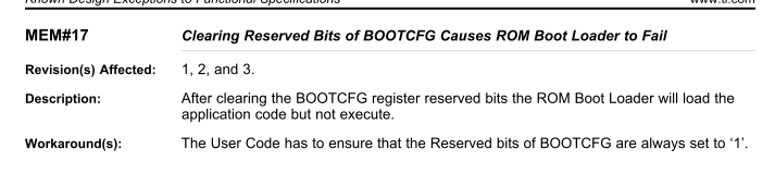

I have a question with regard to the new MEM#17 errata.  I am not familiar with the BOOTCFG register, and don't have any code to explicitly do anything with it.  Do I need to be concerned about this errata

    If not using the BOOTCFG register, then you do not need to be concerned about the errata,

    Indeed. There are 4 main functions in the BOOTCFG register
    1. Bits 1-0 control the Debug Port. If the value is changed from the default 10 and committed then JTAG debugger access are inhibited for further access.
    2. Bit 4 controls the KEY value for commit operations. Default value of 1 means a Key of 0xA442 while a value of 0 means the user can have a custom key in the FLPEKEY register for any Flash Program/Erase or commit operations
    3. Bits 15-8 are used for BOOT Pin Configuration. Only one Port-Pin can be selected for forcing the device to ROM Boot loader on a Power On /Pad Reset even if there is a valid Application code resides at location 0x0. This allows for OTA updates when a custom boot loader is not required
    4. Bit-31 when 1 means the register is not committed and can be used by the application to decide if the change is temporary or permanent.
    The reserved bits shall be maintained as 1. If any bits is changed from 1 to 0 and committed then only a Debug Unlock Sequence can turn the register back to its POR value.
