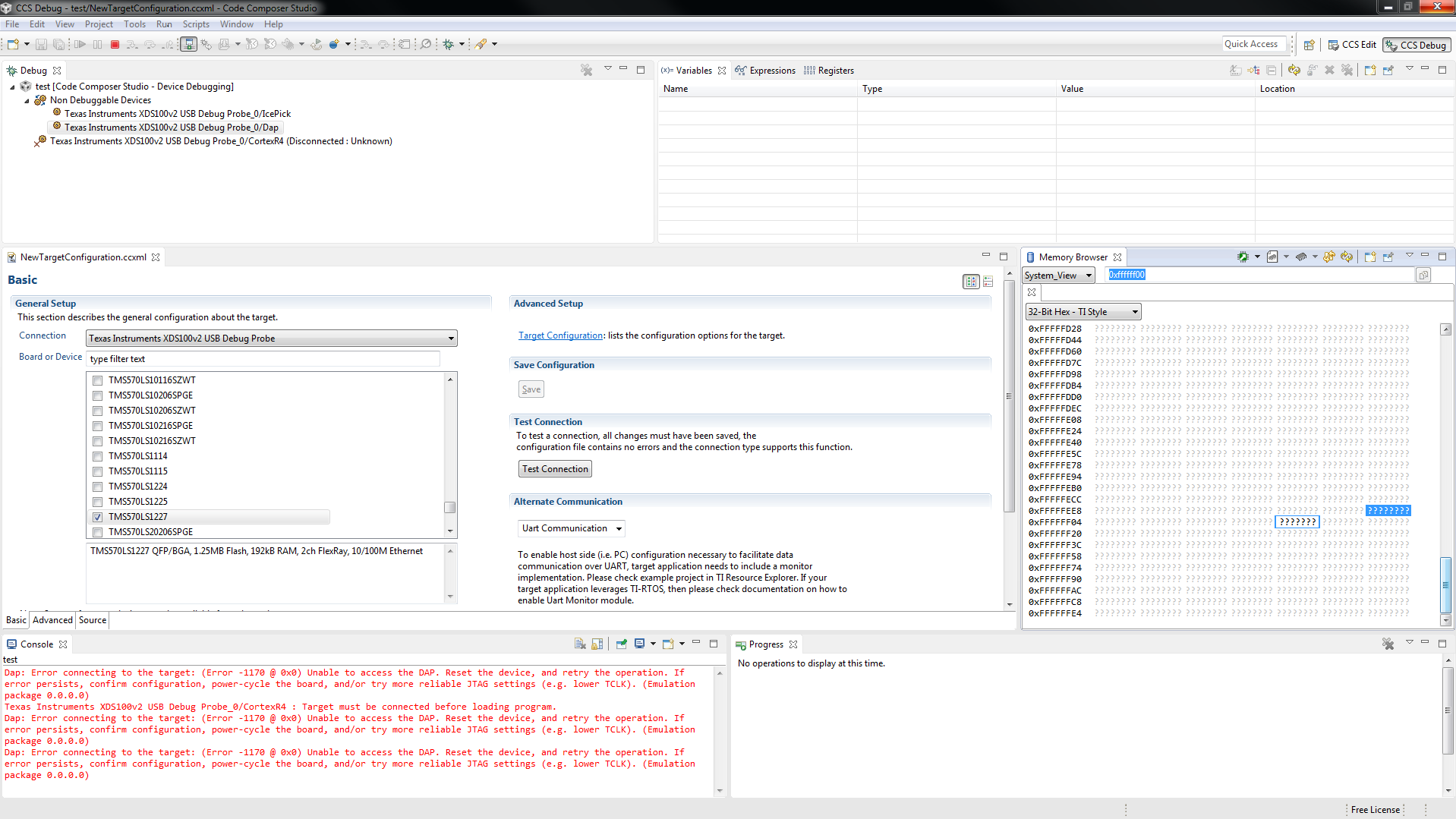

The problem shown there is pretty similar to mine so I tried to follow the sequence suggested by the TI employee and I got stuck in the step 5 (I cannot connect the DAP). If I try (as suggested a couple post later) to reset the device before going to the next step it allows me to connect de DAP but when I open the memory browser, the highest memory address that I can acces is 0xFFFFFFE4 so I cannot go forward to the next step. Also, all the memory adressess are shown as ???????? so I could not change the value even I I had access to it. Moreover once I reach this point the program (CCS6) always crashes and I have to restart it. I have attached an image of the screen at that moment.

  • Normally, this target connection issue is caused by some error in the application. CPU will start execution after reset is released. When you tried to connect to CPU, the error occurred. The error causes CPU to some unknown state so that you cannot connect to it. One way to solve this issue is to hold the nRST pin and release it simultaneously when you hit connect to target in debugger. The purpose is to halt the CPU before the error is generated.
    To prevent this type of error from happening again. I would suggest you replacing the instruction "b c_int00" at address 0x0 to "b #-8". With this change, CPU will loop around at address 0x0 after reset. You will need to use debugger to force PC to c_int00 to run the application. In this way, you can always connect CPU after reset. It also makes debugging easier.
    Thanks and regards,
    Zhaohong
  • I had to try a couple of times before getting it but it worked perfectly. Thank you very much.
