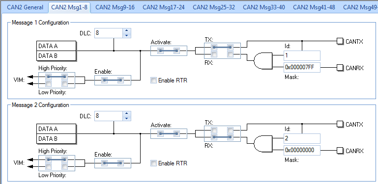

Hello all,
I have problems receiving can messages. I'm working with a LAUNCHXL2-TMS57012 and I configured CAN2 for sending messages via Messagebox 1 and receiving messages via Messagebox 2 using HalCoGen like shown below.
I also enabled the VIM Channel 35 CAN2 High Interrupt.
I'm able now to receive messages and send messages. But after I send the first message I don't receive any messages any more. I dont even get an RX Interrupt. On a CAN-BUS monitor the messages looks fine.

    thank you very much for your reply. I just looked at the example code of the bootloader but I can't find a out what I'm doing wrong. In principle I'm doing it the same way. I tried to break down the the problem and I figured out that I don't receive any messages any more after I write the the message number of the transmit messagebox (1U) to the IF1NO register. I don't get any receive interrupts any more but I still get transmit complete interrupts after each message sent.

    Furthermore the code works fine as long I only receive can messages. After the first transmit I don't recieve any messges any more until I reset the controller.

    I finanly solved the problem. While debugging I observed the CAN Message RAM. After the first transmission and after the next message I want to receive I found the missing message in MessageBox 1 instead of MessageBox2. The reason is this part of my transmit function:
    _p_Handle->p_CAN->IF1CMD =  (1U<<7)     // WR
                               | (1U<<6)     // Write Mask Bits
                               | (1U<<5)     // Write Arbitration Bits
                               | (1U<<4)     // Write Control Bits
                               | (0U<<3)     // CtrlIntPnd
                               | (1U<<2)     // TxReqst
                               | (1U<<1)     // DATA A
                               | (1U<<0);    // DATA B
    with (1U<<6) I accidentally overwrotte the maskbits of MessageBox 1 so that the message I want to receive seems to be  accepted by this MessageBox.
    The correction below solves the problem:
