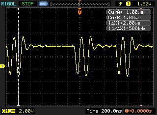

  • Hello Paulo,
    Can you connect a LA or Scope to the communication pins between the display and the launchpad and see if any response is returned by the panel during the setup?
    Amit

  • Hello Amit,
    I will have access to a scope on monday. I will check on that and get back to you.
    Paulo

  • Hello Paulo
    Any update on the check from scope? Of course cb1's point are very valid as well on a possible faulty unit if the back light does not come up either.
    Amit
  • Hi Paulo Costa,
    The booster pack for Kentec QVGA S-1; the latest available now on TI eStore is SPI interface. And all the examples on tivaware are for old booster pack which is 8-bit parallel. Have you written new drivers on tiva MCU for SPI interface? I also checked new kentec booster pack with tiva MCU TM4C123it was not working because of driver. but when I checked with MSP432 launchpad the kentec booster pack is working fine. Since the MSP432 driver example is in SPI interface. Please check the pin configuration and SPI drivers. Hope this will help.
    Thanks.
    Abdu Sattar Malokani
  • The example you linked above all using 8-bit parallel interface driver. So they will not work with new Kentec booster pack (which is SPI Interface). Have look at MSP432 Kentec SPI drivers and modify accordingly. thanks.
    Sattar Malokani

  • TI did not Highlighted about that change from 8-bit to SPI. I was also struggling that what is wrong with Tiva TM4c123, but when I read the Lab10 tiva workshop then I found that there they are using 8-bit parallel interface, while the new booster pack (Kentec QVGA S-1) is designed with SPI interface. Other free pins they have connected to the ground so there is no way to use 8-bit interface with tiva series. only way is to write new SPI drivers.

  • Hello Sattar,
    Then the display driver code from the DK-TM4C123 panel may be used as a builder for the new SPI interface. Honestly, I am surprised by the change as well.
    Amit
  • Hi Amit Ashara,
    Here are the drivers for the TM4C123gx launchpad. I hope these will be helpful for others also.

  • Hi Amit,
    I spent some time trying to figure out how to capture a signal from the osciloscope I have access to (Rigol DS1052), but there's not digital analyzer in it, so I just got Analog readings from a few pins.
    I wasn't sure where to look, so I looked at PA5 (Write control signal) , PA6 (Register/Data select signal) and PE4 (X+ on the boosterpack).
    This is PA6:
    This is PA5 (this is a very weird signal to me):
    And PE4 shows nothing (which is supposedly an input).
    Also, the backlight is not turned on when I connect the USB. Are there any tests you may suggest that can be more informative (I don't think these bmps tell us anything).
    Paulo
