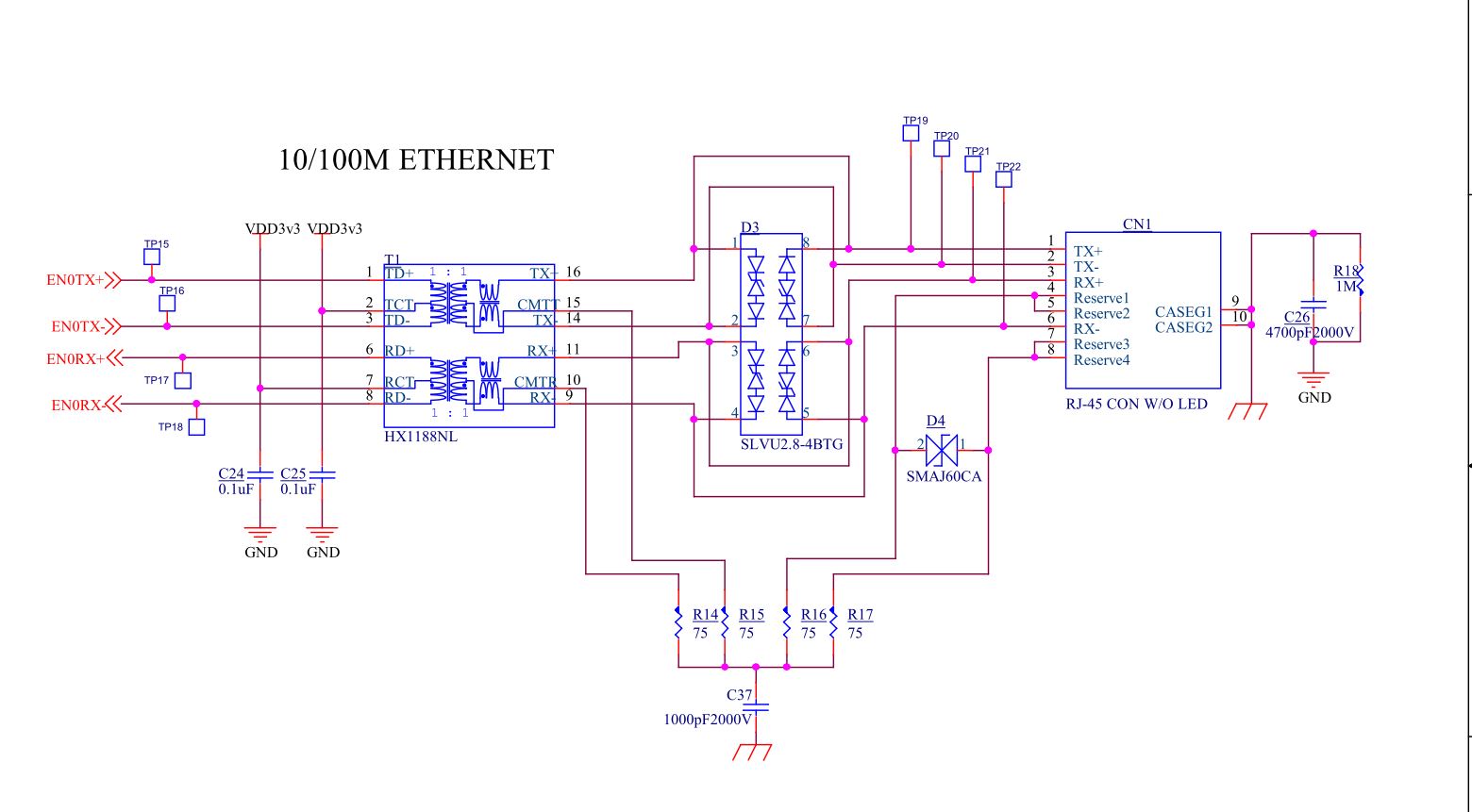

  • "But Ethernet doesnt work on our ev-board with the same firmware"
    Might that question make more sense to post a schematic of said ev-board?
    What MPU etc. does (our) ev-board use, does ev infer a custom board?

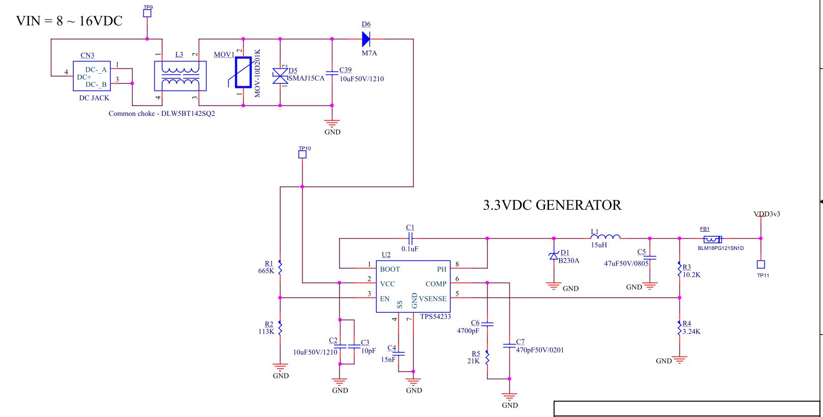

  • thx for your concern
    i post the relative schematic for our customer board.
    best regards
    alex wang
  • Hi Alex,
    Thanks for post schematic worth 1000's words alone.
    Couple questions;
    Why no  Vbat series resistor (51ohm) and (.1uf) to GND mounted near pin 68, insures very critical voltage rise time requirement into MPU?
    Reset pin with zener diode alone may not give ample reset period, Typical is GND__/  --100ohm--10k^(VDD)--Pin70--.1uf GND. (DS page 1834)
    Does your Dev board have Y2 same 32Mhz?
    Check external Vref (DS page 1858); vRef @+2.4v is minimum and requires CTL register settings.
    Hope these checks help.
     Later notice missing 2k series resistor into OSC1 pin 89, Do insure 25Mhz oscillates at the correct frequency.

    How standard the TI reset circuit illustrated in past Stellaris DS, expect to find some where in TM4C as well. Suggest TI deploy a schematic tool for users to add convey short illustrations into forum posts. POR reset timing is critical for many MPU, designers must pay attention to the TM4C Vbat pin rise time in reference to POR cycle time. Oscilloscope 2 probes will confirm if each is within tolerance.
    Try again: GND__^__ ---100--- Pin70---10k---VDD, Pin70---|.1uf|---GND

  • Take it PB1 is the input leading to MPU reset pin 70.
    Should Alex not be programming the hibernate module Y2 might can be removed and ground pin 66 OSC0,   WAKE pin 64 is already at ground. Wake being grounded with Y2 installed seems oddly out of place since PIOS can provide 16Mhz for both ADC clock and WDT1.
    Pin 64 often has pull up of 1 megohm connected to VDD when Y2 is added. That makes ready the hibernate module to program. Unless your program configures the real time clock or hibernate module why is Y2 even needed?
    Removing Y2 eliminates the requirement to delay +Vbat and removes need to add .1uf capacitor, 51 ohm series resistor.
    Read today the ROM boot loader my enable USB pins 93/94 (page 1822) when flash is erased. Suspect to start a binary file transfer in response to a ping request. Think that ping control is similar to a magic packet sent by the server during Bootp hand shake.
