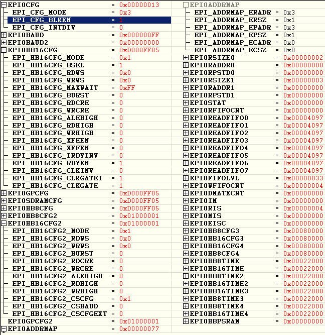

I'm setting up the EPI interface on a TM4C1294NCPDT on an EK-TM4C1294XL launchPad board. In HostBus16 mode I can write to the 16bit EPI bus but I cannot read from it. The addressing, byte selects, read pulse and chip select all function as expected. I see data appear on the bus when the read pulse goes active, but the data read from it always reads zero. Writes work fine except I don't see the bus being stalled for multiple writes when the iRDY signal goes low. I can read the status of the pin associated with iRDY with other code and it works okay but I need it working with the EPI transactions. I've tried the active state of iRDY set both ways round.
The EPI bus is being read with the assembler lines:
BASE_ADDRESS                 EQU     0x60000000
LDR R0, =BASE_ADDRESS
LDRH R1 [R0]  ; load 16bits (Half word) from address 0x60000000
I've also tried reading all the addresses in the 64KB address range 0x60000000 through 0x6000FFFF with some of the bits on the data bus pulled high, but always get 0x0000. I feel I'm missing something here in terms of setup.
Some questions:
1) Anybody know what's going on? :) And why I can't read data in?
2) Do the FIFOs have to be enabled to read from the EPI bus? The datasheet is very good but not especially clear on this. The EPI block diagram suggests not.
3) Any idea why iRDY doesn't stall bus writes? Or does this only kick into life when the FIFOs are used?

    Adding a picture - this should detail the register settings after EPI initialisation with the above sequence:

  • Dear Amit,
    After a looooooong investigation and much reading I've discovered what's wrong, and why I can't read from the EPI interface, in either HB16 mode or General purpose mode. The GPIODEN settings for each pin/port used need to be set to enable before the EPI will read in. Sounds simple that doesn't it, but it's not mentioned anywhere in the EPI module chapter of the datasheet DS-TM4C1294NCPDT-15863.2743 SPMS433B.
    Enabling the GPIODEN settings when the pins have alternative functions enabled is mentioned in other modules such as the ADC, but not for the External Peripheral Interface. Unfortunately for me this is the first application I've written on the TM4C1294NCPDT. If there had been others I would of realised the problem. I think mention of GPIODEN is particularly worthy of the EPI initialisation section as its omission causes a problem that suggests you have a working module but other setup problems.
    Amit. In the course of solving the problem I have read the EPI chapter over and over and now have a list of minor corrections and recommendations that I would like to submit for inclusion in the next manual rev. How do I do that?
