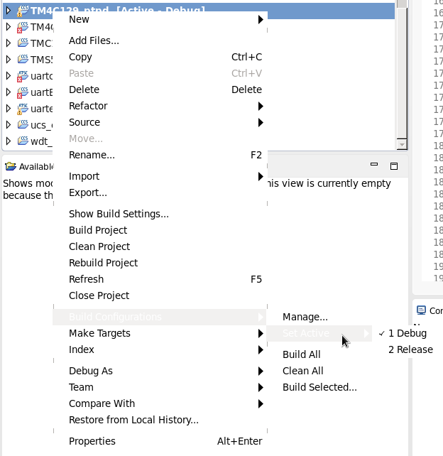

I am trying to learn embedded programming using Tiva-C launchpad and CCS environment, using project0.
I am able to run the project in debug mode, and it works great.
Now I want to program the board in release mode. is there a way to do that with the current setup, or do I need a production programmer to do this?
    In CCS the Debug and Release configurations are just ways of compiling a project with different compiler options.
    When a new project is created in CCS, Debug and Release configurations are created and the Debug configuration is selected by default.
    If you right-click on a project in the Project Explorer you can change the active Build Configuration from Debug to Release:
    With the active Build Configuration set to Release, when a debug session is started CCS will load the program build in Release mode to flash. You can still debug a program compiled in Release mode, but depending upon the compiler Optimization used you may find the program does not single-step in statement order as the compiler may re-order some instructions.
