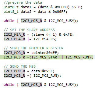

I am trying to make my own interface with the Sensorhub TMP006 sensor, using I2C. Right now I'm only trying to write to the config address in the TMP006 module.
I followed through some of the sensorhub example program, as well as the Datasheets, and I cannot understand what is wrong and why the code is not working. Here's the line of code that gives me trouble:

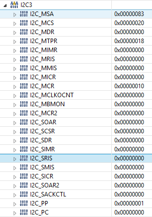

I'm not sure how it's best to show how I configured the I2C3 ports, with code or with the Register maps. I'll go for both. Right before I run the highlighted line, this is how the settings for the I2C3 regs are:
The SYSCTL regs seem fine, for PortD. This is the Init function (clock is confirmed 50 MHz):

Anyways, once I run the function, the MCS register becomes busy:
And then it gets stuck in the while loop. I am pretty sure the hardware is connected correctly, as I've run the example project with success. I cannot understand why it's staying on the busy loop, and why the write isn't happening.

    1. When a MCS register operation is requested you must wait for the Busy Flag to get cleared before doing the next MCS operation. This is not the case in the code you sent. Also since there is a delay from MCS being programmed to the flag getting updated, a small delay loop of 10 would be a good line of code to have

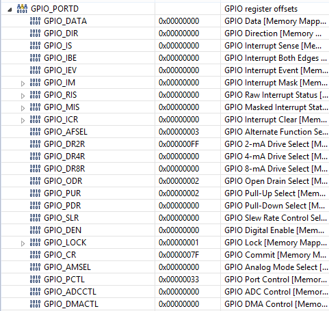

    Here are my GPIO settings right before the troublesome line:
    I set up PUR as a test, but it didn't help.
    Paulo
  • Hello Paulo,
    The GPIO_DEN register bits are not set for the corresponding pins: Digital function will not work without the same. This is one major setback when using DRM style of coding. This could have been easily avoided by using TivaWare and I reckon this is not going to be the last of the issues if DRM is continued further (Stong Advise: Move to TivaWare)
