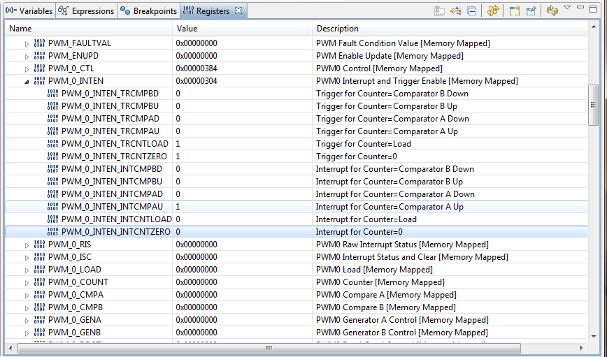

PWM0 GEN0 Interrupt ADC on count zero & CCS Debug show Interrupt Comp A up?
Guru 56143 points
Version: TivaWare_C_Series-2.1.0.12573
Checking the PWM peripheral configuration in CCS debug reveals GEN0 trigger & interrupt enables are not being configured properly to the reset defaults.
Why is this happening?
// Configure PWM Generators:
    ROM_PWMGenIntTrigEnable(PWM0_BASE, PWM_GEN_1, PWM_INT_CNT_ZERO | PWM_TR_CNT_LOAD);

  • Mon Ami,
    Code blurb you present does not (really) configure PWM_GEN_0 - does it?     Might the following better meet that objective?

  • Was referring to the generator trigger and interrupt enables appear to be not configured properly by Tivaware.
    Gen # + 4 |= ui32Trig don't  = 44,84,C4,104

  • Tiva code is correct since PWM_GEN_1 = 0x80 + 4 = 84 . Yet debug shows PWM_GEN_0 configured but are not using Gen 0 at this time and it should be 0x0000.0000
  • Later occurred to me EN0-LED0, EN0-LED2 use GPIO ports of GEN0 A/B outputs. Appears CCS debug can't tell the difference in the peripheral AFSEL configuration.
