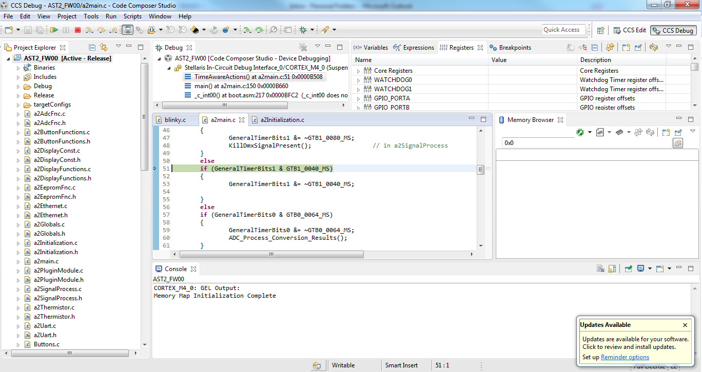

I have produced a new pcb with TM4C1231. The first programming by CCS is without problem, but debugging or next programming FLASH is not possible. Downloaded code was running (debugging) on older pcbs without problem. I have not locked JTAG by my code!
********** Console output ***************
CORTEX_M4_0: GEL Output:
Memory Map Initialization Complete
CORTEX_M4_0: JTAG Communication Error: (Error -1170 @ 0x0) Unable to access the DAP. Reset the device, and retry the operation. If error persists, confirm configuration, power-cycle the board, and/or try more reliable JTAG settings (e.g. lower TCLK). (Emulation package 5.1.636.0)
CORTEX_M4_0: Failed to remove the debug state from the target before disconnecting. There may still be breakpoint op-codes embedded in program memory. It is recommended that you reset the emulator before you connect and reload your program before you continue debugging.

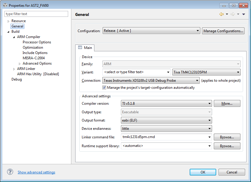

  • Hello Jan,
    More issue uncovered.
    General Device endianess is "little" and not "big". Output format must be eabi
    Build -> ARM Compiler -> Processor Options: --silicon_version must be 7M4, --code_state 16 and --float_support FPv4SPD16
    I would suggest loading a default project from TivaWare to make sure all settings are corrected first. After making corrections I could get it to execute using Step debugging. Close CCS, erase and launch.
    Amit
  • I have it set as you describe. Everything.
    May be you have opened bad project file.
    Jan
  • Hello Jan
    I imported the project file in CCSv6.1 and that is what I saw. Also to double check I opened the zip files .cproject file in a text editor. Below lines indicate you have loaded a TMS470 class device and not a TM4C class device.
    <listOptionValue builtIn="false" value="DEVICE_CONFIGURATION_ID=com.ti.ccstudio.deviceModel.TMS470.GenericARM7Device"/>
    <listOptionValue builtIn="false" value="DEVICE_ENDIANNESS=big"/>
    Amit
  • 8055.AST2_FW00.ZIP
    Here is a new one with settings shown in the picture.
    J an
  • Hello Jan,
    OK. So the issue was that you had Release configuration made active while it was setting Debug Configuration on my side. I do not have the same device as you have but followin snapshot shows that it works all the time for me on a TM4C123GH6PM device. I can step-run-halt-disconnect-connect without any issues.
    Amit
