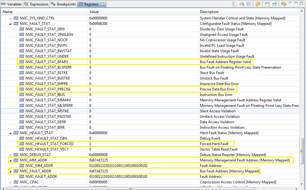

Almost seems as if a trace on EK-TM4C1294i3-XL PCB could be crossed with some other trace or internal NVIC line/register.
Seemingly out of place the EPI0 peripheral is not configured yet the External power control for EPI0 in CCS debug is showing set 1 enabled. That EPI0 happens to fall on the NVIC fault address more than one time (0x67AE7225).
Control register 7 has RESC=0x8 or WDT0 interrupt was cause of the MPU reset.

Bus Fault:

    Duplicated fatal buss error with WDT0 remains constant:
    Note that the CCS refresh is not set, which may keep the last read value on the screen with highlight ON.

  • The highlight values were updated and asserted right after clicking Pause during the IntFault() trap.
    Will try refresh to see what if anything changes in that behavior.

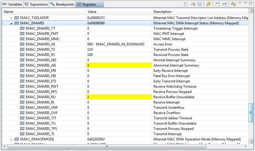

    Traced issue to last pending interrupt is EMAC0 and (EMAC_INT_RX_NO_BUFFER), was not WDT0 interrupt as earlier believed. Debug register Interrupts show the Bits not the actual interrupt that asserted. Hard to grasp that when seeing the word Interrupt first then Bits[xx]  following. So we then have to go to data sheet and cross examine the interrupt table to convert the position. Part of the learning curve built into CCS.
    Added the EMAC_INT_RX_NO_BUFFER flag into the WDT0 interrupt handler and it constantly interrupts.
    The EMAC_INT_RX_NO_BUFFER has been set to interrupt, in belief that the DMA engine then sets the RESD0 descriptor bit position to indicate an interrupt occurred. That topic is not well discussed in the datasheet text and leaves one to assume they must set the interrupt source NVIC in order for the flag to ever assert. Oddly there in no such interrupt  bit RESD0 = EMAC_INT_RX_NO_BUFFER so the abnormal interrupts count never increments.
  • BTW: This project is using Tivaware driver library 2.1.1.71 as a project dependency.
    EMAC_INT_RX_NO_BUFFER | EMAC_DMARIS_RU both == 0x0000.0080 and makes WDT0 fault continuously.
    Oddly CCS debug continuous refresh posts DMARIS_RU/RI flag when suddenly MPU Halts. That behavior tends to infer the bit position in the [Int_Rx _No_Buffer] flag is incorrect.

  • Hello BP101,
    It seems that there is no Receive Buffer available for offloading the data from the EMAC Engine in RDES which is triggering the interrupt. Could it be that the process of allocating buffers is slower than the input data?
    Amit
  • Think RBU is the after math of the disaster in memory NVIC Bus Fault 0x67xx.xxxx. Above post WDT0 interrupt required (&=) order to compare and test the No_Buffer/No_RU register flags. Dog is no longer barking continuously. Strange the compiler can not (if) test a register contents retrieved value (==) with a static variable.
