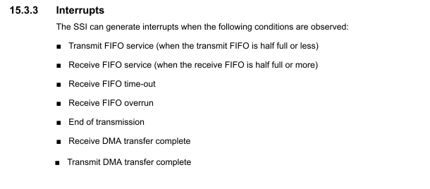

As stated in section 9.2.10:
"When a μDMA transfer is complete, the μDMA controller generates a completion interrupt on the interrupt vector of the peripheral. Therefore, if μDMA is used to transfer data for a peripheral and interrupts are used, then the interrupt handler for that peripheral must be designed to handle the μDMA transfer completion  interrupt."
Accordingly, I find the following list of Interrupt events in the SSI Section of the datasheet: (I could not find any similar list in the General Purpose Timer section of the Datasheet)

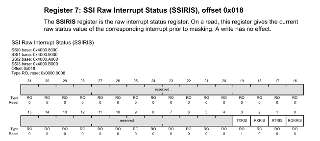

However, I look at the description of the SSIRIS register, there are no such interrupt bits defined at the locations that the TivaWare Functions would suggest (bits 4 and 5):
(As a side note, when looking into the TM4C129 datasheet, these bits seem to exist in the SSIRIS as well as the GPTMRIS registers).

  • Hello Roman,
    On TM4C123 the DMA Completion was not straight forward. When the DMA completes it gives an interrupt on the Peripheral Channel which it triggers it. In this case it the Timer. So the Timer Interrupt Handle must be invoked where the check on the DMACHIS needs to be done so as to find the completion of a DMA Transfer..
    Amit

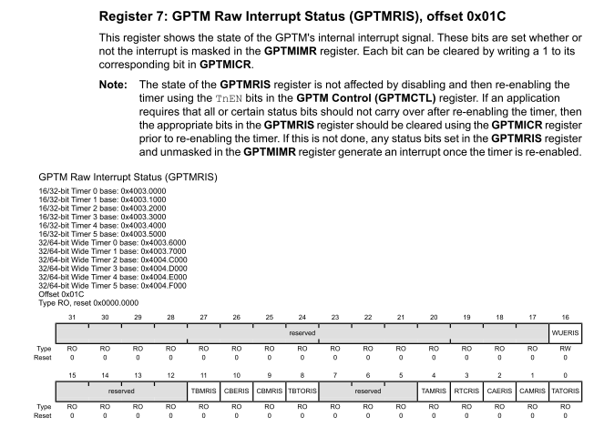

    I checked both the SSI and Timer Interrupts for DMA completion indications. However, also in the GPTMRIS there are no such bits:
    I would have wanted to look for these interrupt status flags to see a DMA completion.
    Please correct me if I am wrong, but do you suggest to ignore the state of the Peripheral RIS register and if DMACHIS for the corresponding channel is set, I know that the interrupt was caused by the uDMA?
    Roman
  • Hello Roman,
    Yes. Enable the Interrupt from the Peripheral that is triggering the DMA request. And in that Interrupt check for the DMACHIS bits for DMA Status.
    Amit
