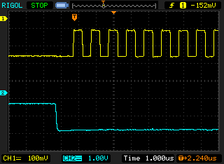

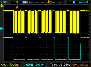

    I changed your first problem. For second problem I don't think it matters because I tried all four different mode 0,1,2,3. They all give me the same thing-no output. Below are my screen shots showing SCLK, SDATA, FSYNC timing diagram. I only have two channel, so first plot is SCLK + SDATA, and the second is SCLK + FSYNC. In my view they all look correct. The third plot is a starting condition (SCLK + FSYNC). By doing this, I put the sending for loop inside of a while(1) loop just for continuously showing waveform, but for the AD9833 initialization, this five sets of data only needs to be written once (outside of while(1) loop).
    There are five sets of SCLK signal. Channel 2 is my SDATA, and it is the data I wrote in my program.
    Channel 2 is te FSYNC, as it should be, it is only pulled to high in between of two sets.

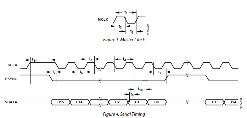

    This one shows the starting condition, which I am not quite sure it is right. In figure 4, which is the timing diagram from AD9833 datasheet. t11 is at high, but in my screenshots, SCLK starts from low. I am not sure whether this is the point.

    Yes, even the data sheet for AD9833 mentions that explicitily. You may have to use SSI_FRF_MOTO_MODE_3 instead of the SSI_FRF_MOTO_MODE_0 in the SSI Controller.

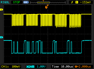

    Below is the plot of SCLK + FSYNC
    Below is the plot of SCLK + SDATA, which looks wrong comparing to the data I want to write.

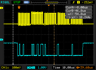

    If I change the while(SSIBusy(SSI2_BASE)); back to outside of the for loop, which is:
    for(index = 0; index < 5; index++){
    SSIDataPut(SSI2_BASE, dataTx[index]);
    //while(SSIBusy(SSI2_BASE));
    while(SSIBusy(SSI2_BASE)); // waiting if data is sent
    it gives me the SCLK + FSYNC waveform of:
    No matter how I change mode and position of while(SSIBusy(SSI2_BASE)); there is still no output.
  • Hello Jingyuan
    Why is the Data wrong when compared to the data you want to write in the 2nd plot? Also you would need to put in the SSIBusy condition as only then will you have 5 distinct transfers while toggling FSYNC
    Amit

    The data is wrong in second plot, if you go back to where I sent you SDATA plot first time. They are different. Then, I don't quite understand what do you mean by "Also you would need to put in the SSIBusy condition as only then will you have 5 distinct transfers while toggling FSYNC". Does that mean SSIBusy condition should appear where I finished sending all five words, which is the outside of that for loop?
  • In short, if I put SSIBusy condition inside of the for loop, it gives me the wrong SDATA. If I put SSIBusy condition outside of the for loop, it gives me the correct SDATA.
  • Hello Jingyuan,
    Please read the data sheet for the different modes of SSI especially the section for continuous transfers. Note that what you are interpreting as wrong data is during the time FSYNC is high and must be ignored by the slave device (unless the slave device really care what is there on the data bus when FSYNC is high)
    To test the theory, I would suggest using a bit banging of the GPIO pins to emulate the SSI protocol and then see if you can get the correct waveform of AD9833 device.
