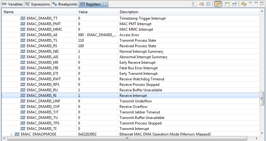

    Case EMAC0 receiver asserts INT 0x8080 (32896) AIS/RU end up crashing the EMAC. Reading EMACMARIS the RI bit is not set with AIS/RU, guessing since the FIFO has the start of the frame during RU. Then Interrupt status 0x180c0 (98496) NIS,AIS,RU,RI starts posting but only after some time has passed and numerous AIS,RU flags are first reported by EMACDMARIS.
    Seems the application was working from the masked status word upper 31:17 bits and generating a SW56INT instead of using HW interrupt status to resolve RU condition. That approach might be ok until the EMAC is being heavily stressed or actually runs out of RX buffers then what?
    The interrupt clear seemingly should test for flag bit NIS/AIS and appears was testing for all status bits and only OR the flag bits [15,17] AIS/NIS to (ui32IntFlags). That has been changed below and is clearing all interrupt sources. So far is working but won't know until RU ever occurs again, praying it don't. Making the change above post the EMAC receiver stayed connected to IOT for 50k seconds. The EMAC receiver randomly drops IOT at 10-16k seconds before DMARIS reported AIS (32896) RU.

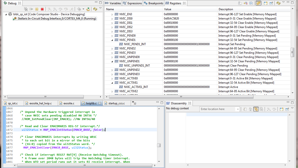

  • CCS debug now showing the HW interrupt 56 bit 40 (32-54) as disabled bit position 9 after enabling privileged mode versus setting CFGCTRL, MAINPEND=1.
    For some reason CCS Debug NVIC_SW_TRIG bits do not show any changes during refresh but the mask bits of DMAMARIS are all being reset after changing the  |= to &= of all NIS/AIS source INTS.  The strange part is the UARTprintf() messages would print the AIS status bits multiple times in looping not clearing them between IOT connection attempts.  That symptom would seem to infer the DMAMARIS set & clear was failing so try hard to locate the cause.
    Masking NIS/AIS all bits had issues that appear in the interrupt Priory group 4:4 NIL rule as LWIP timer HW INT39 was  below SW INT 56. When the priority of LWIP timer priority level was set farther down the 3 bits grouping say 0x10 versus 0xA0, NVIC would raise exception 11 bus error shortly after POR. The bit positions in the grouping priority has something to do with the error cause. Find it odd that EMAC priority 0xC0 and LWIP timer priority 0xA0 the third bit positions are in line to binary 4:4 priority.
    At least learning few things about MPU protected memory mode TEX,S,C, AP bits, adding code below for enabling SW triggers in NVIC per-data sheet.

    More strange SW56 interrupt happenings may just be CCS5.4 debug causing but not sure just yet.
    EMAC INT56/40 bit 9 is disable in CCS debug ( INT32 - 63), assumed was made disabled after redirecting NVIC over to SW INT56. Oddly the disabled HW INT56 randomly asserts pending in CCS debug after many hours of run time. Note we can not see SW INT56 being triggered in any debug NVIC interrupt registers.
    When disabled HW INT56 randomly asserts pending CCS debug register refresh cycle stops & presumably halts the TM4C123 ICDI yet does not cause an exception fault in TM4C1294. Upon stopping CCS debug the TM4C1294 resumes and continues adding to IOT time since reset seconds count remains connected to Cloud reporting http 204 status events. That is not always the case and sometimes an exception 11 follows that random interrupt event in TM4C1294.
    How is it possible a SW INT56 is randomly switching into a HW INT56 is the question of the day?

    That is what the code appears to do, EMAC HW INT56 is set enabled (tiva-tm4c1294.c) and SW INT56 triggering inside LWIP timer call function. Long ago added an unpend statement for SW INT56 into the interrupt handler, later comment it out not understating both HW/SW INT56 were both firing. Today added that NVIC unpend INT56 back into the interrupt handler. Apparently we must handle the HW interrupt clearing when NVIC sets pend and not just clear DMARIS as the code was doing.
    Seems when both HW & SW INT56 ties NVIC, he sets a pending status on the (disabled) INT56/40 bit 9 in CCS debug. Sometimes that pending status quickly goes away, assume SW interrupt. Other times pend 56 stops the application in pending status, assume HW 56 is not cleared. Polled level interrupts do not typically auto unpend unless they are pulsed and SW interrupt. How HW/SW INT56 is even working together amazes, not without throwing all caution to the wind as it seems. Believe HW INT56 is asserted when an obscure EMAC DMA condition as it does not raise HW 56 flag very often yet it does. Think it may be safer fewer issues to not use a SW INT56 trigger in the LWIP timer and just poll the HW INT handler as to advert would be NVIC ties for the same interrupt.
    Random exception 11 appears to lean more as interrupt, EMAC DMA, timing related issue about the interrupt vector handling. CCS debug reveals the EEROM is still incrementing R/W address and the LWIP timer counting after the phantom pend suddenly stopped the application.

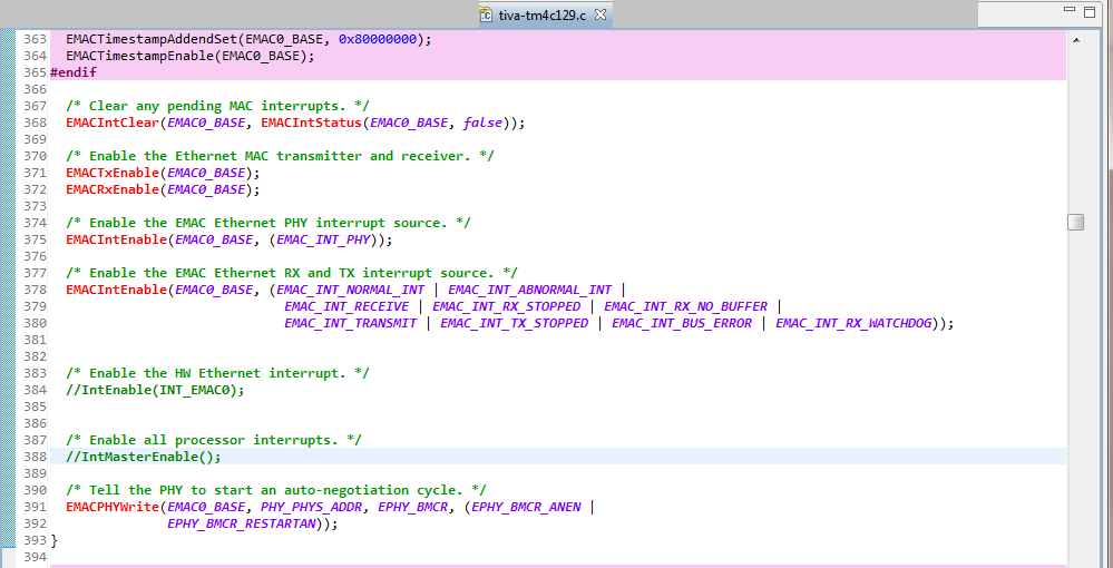

    Thanks for assistance and why not try this out with qs_iot to confirm IRQ56 behavior.
    The NIS/AIS interrupts were not enable in the vanilla code as they are in post above.

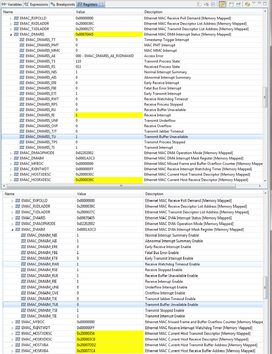

  • CCS5.4 debug simulator may be part to blame in strange DMARIS -IM registers reading - not the first strange debug post ever captured.
    Have to LOL what we see here TU & TI stopped updating these bits in simulator, complete nonsense being EMAC is transmitting just fine at this time.

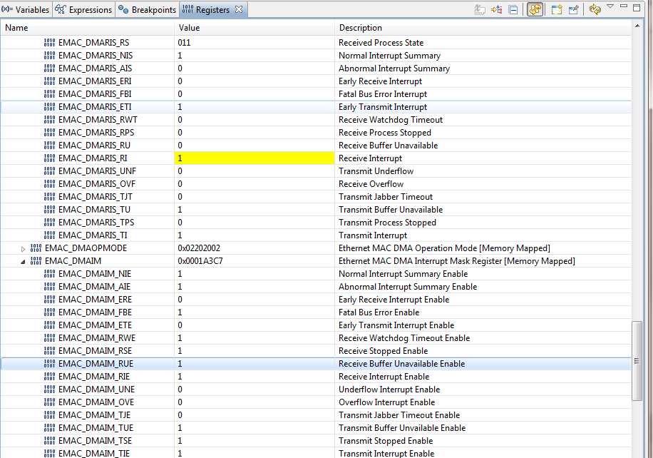

  • Ops our bad as we never enabled the TU bit interrupt in EMACDMAIM in above post. Point is we only use the NIS bit to flag any of the OR'd individual enabled interrupts as they are set in the IM. So we don't mask or flag all the OR'd interrupts of NIS, AIS if any single interrupt is enabled as it was programmed in the Tivaware library.
    That view point original EMACDMAIM set bits logic may work for awhile but seemingly is backwards at the program level and at heavy load high speed faults (11) like a mad man with hatchet.
  • TI and TU are happening so often the debug DMARIS bits set 1 above post were only changing 0 but for a brief second. That is until the Telnet client connection has been closed. Then TI, TU bits become more cyclic in a near 50:50 duty cycle.
    TCP Nagle algorithm disabled for the high speed Telnet client is causing a high TX rate, 25mbytes/second. After many hours of sustained operation the TI, TU bits appear to stay set 1 frozen as if all TX descriptors have been used in an never ending chain ring.
    Likely TI, TU are changing so fast in CCS debug the simulator refresh rate is ignoring any time under 1 second for rapid register updates.
    A preventative measure might include increasing TX descriptors from 8 to 16 as not to cause a fault TU - MEM_ERR, questionably raising exception (11)?

    Agree that might be what was happening at that point in debug time since TU interrupt was not masked in DMAIM.
    Early on posts had claimed to set TU, TX_Stopped mask bits DMAIM enable and added TU flag into the interrupt handler (tiva-tm4c129.c) and later removed both during trouble shooting. Both interrupts were not originally configured, after seeing the debug behavior OR's them with existing TI flag.
    After re-adding both the TU debug bit stated to cycle more often. More importantly now [tivaif_process_transmit(tivaif);] asserts not only with TI but also TU, TX_Stopped time periods. TU might not seem so important but that also helps to mitigate the raising exception (11) during high speed TX data controller access. Unplugging Ethernet cable is good stress test of TX_Stopped interrupt. The good thing is IOT time since reset count picks up where it left off (reconnected) or until the server dumps the http connection keep alive. Watch dog timer1 starts to complain capturing the Ethernet link event moderating the loop. WDT1 not doing much at this point yet realize he could be used to read the DMAMARIS 31:17 bits status and invoke an Ai like action based on reported EMAC conditions..
    Seems EMAC INT56 was being used merely as a SW trigger source and issues in SW interrupt priority queuing appear to raise exception (11).
    Polling the EMACDMARIS register has stopped triggering random exception (11) events at various points in the IOT application. That one random event was most difficult to find cause against all odds.

  • Hi Amit,
    Interesting discovery there all along; DMAIM ETE masked bit is not enabled and RU seems to be reversed with ETI bit in debug. Setting RX descriptors to 4 as to see if RU would toggle more often in CCS debug makes no difference other than posting more frequent code 99525. The AIS UARTprintf() reports code 99525 so the RU bit is actually asserting but not reporting proper debug bit position. Look at above posts the ETI set was assumed to be normal but on review is quite abnormal. : -)
  • Hi Amit,
    Further discovery finds [RI] bit is mostly being set/cleared in debug when the high speed Telnet client is running. Below: DMARIS [RI] should be set at the end of every received (complete) frame. Failure of (slower (IOT) client) [RI] being set in CCS debug to coincide with RX descriptors or near the same interval of http 204 (113 bytes) status messages returned by IOT server to indicate a (frame reception is complete). Should not [RI] be toggling when ever the IOT client receive FIFO has a complete frame?
    Tried adding disable interrupt on complete [31] of RDES1 flag into the chain testing last RX descriptor seemingly has no effect on the RI bit in MARIS. That infers RI must not be disabled as the reason. Not sure can trust CCS debug since ETI is also set only when the high speed Telnet client runs but not for the low speed IOT client. Possibly the CCS debug or DAP is not responding to slower DMA transfer rates but does for faster rates ? Very confusing simulator results input from the DAP CCS 5.4.
    Example: g_pRxDescriptors[ui32Loop].Desc.ui32CtrlStatus = DES0_RX_CTRL_OWN |  DES1_RX_CTRL_DISABLE_INT;

  • Ok RI[1] does change in time but seems far to slow for the amount of frames being received @113 bytes. TCP_MSS = 600 bytes so every 5-6th http 204 should raise RI[1] indicating the end of a receive frame. If RI is not raised at each frame end the RX descriptors will run out raising RU[7] at some later point in time more often leading to exception 11 data bus error. We are seeing exactly that scenario, by the time RU[7] has raised, the lack of PBUFs can not be corrected at the abstraction layer. Slowing down the entire process adding delays etc.. results only to buy more time that the bug inevitably drops the payload.
    Far worse is ETI[10] and ERI[14] are reversed in the asserting of NIS[17] and ETE/ERE not being masked DMAIM should not be set at all.
    Possibly the data sheet incorrectly lists OR summary AIS: asserts ETI[10] and NIS: asserts ERI[14] as debug is showing opposite firing.
