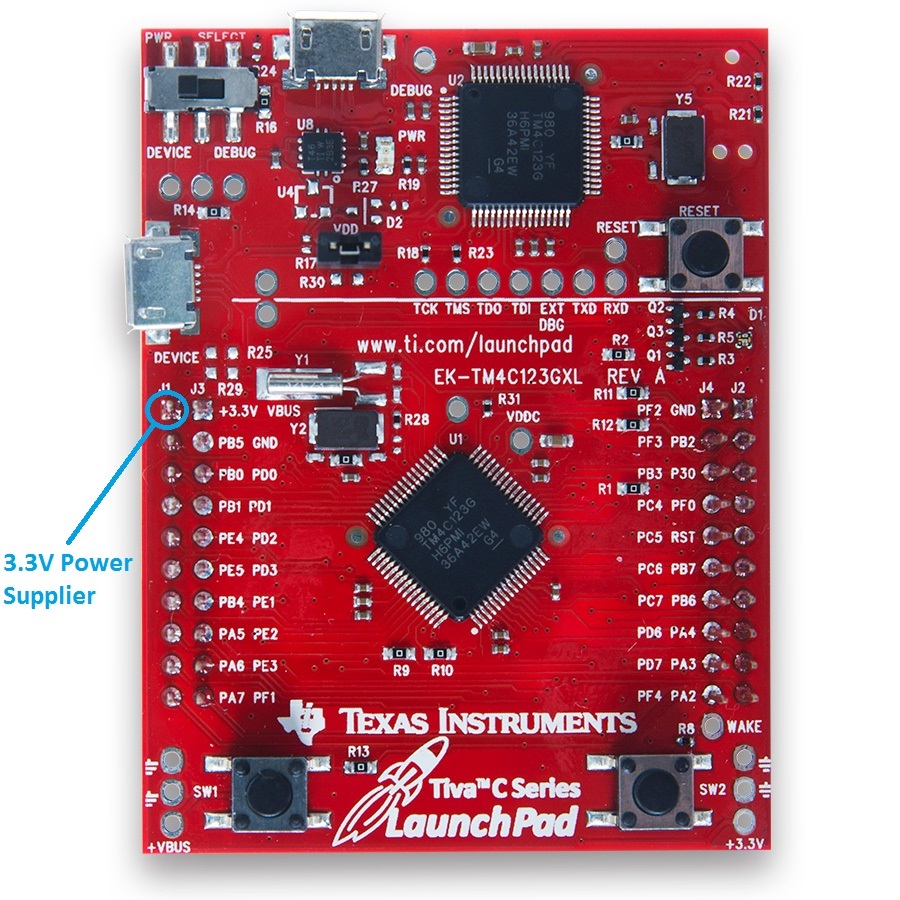

    Which Pin of TM4C123 gives an output of 3.3V? The GPIO's when driven 1 can generate ~3.3V and may be able to drive the CNY70. However if the current drain is to high this may drop the voltage of the device or damage the IO.
    In the past we have used a 3.3V supply with a FET whose Gate is connected to the GPIO to allow for large drive currents.

  • Hello Amit
    I was thinking of supplying power to the CNY70 from the +3.3V pin (as seen in the image). Ground is also from the TM4C's GND port. I would connect the output of the CNY70 to PB0. This was the plan.
