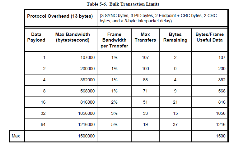

  • Hello Mathieu,
    I think you would need to go through the USB specification. The data rates of 10 mbps is not possible if you check the USB specification on data rates of different transfer types.
    Amit

  • Hello Mathieu,
    From the USB1.1 Specification...
    Amit
  • Hi, okay I get that the max rate is 9.728 mb/s. I got 2 questions than:
    1. How can I increase my speed? It isn t a hardline spec the 10 mb/s, right how they use a FTDI chip and we just want something better that, I already out perf the chip
    2. Tivaware isn't using USB 2.0 ?

  • Hello Mathieu,
    The FT232 device is surely a FS device. I think to get the MCU at full potential a low level bare metal example with minimal software overhead is required. Unfortunately, we do not have such an example and even with the low level implementation the max data throughput will still get capped at ~9Mbps.
