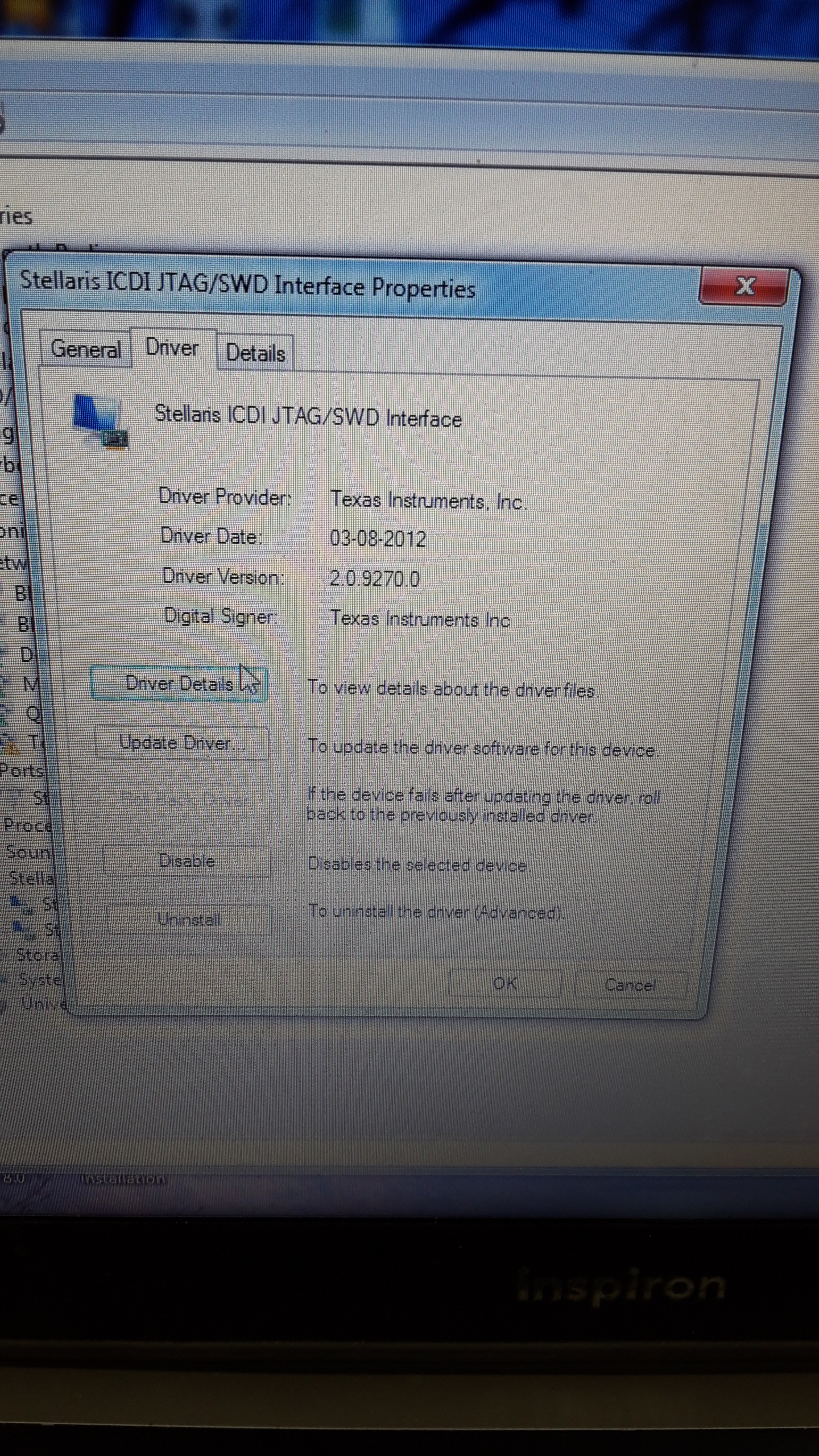

  • Hello Monil,
    So, we do not see an issue for the device being enumerated. The next set of checks
    1. Can you check that the UART COM Port is being displayed in the device manager?
    2. Can you check the date of the driver as shown by property when you right click the ICDI?
    3. Did you check the PA0 and PA1 pins on the DK-TM4C123G toggling when sending and receive data?
    Amit

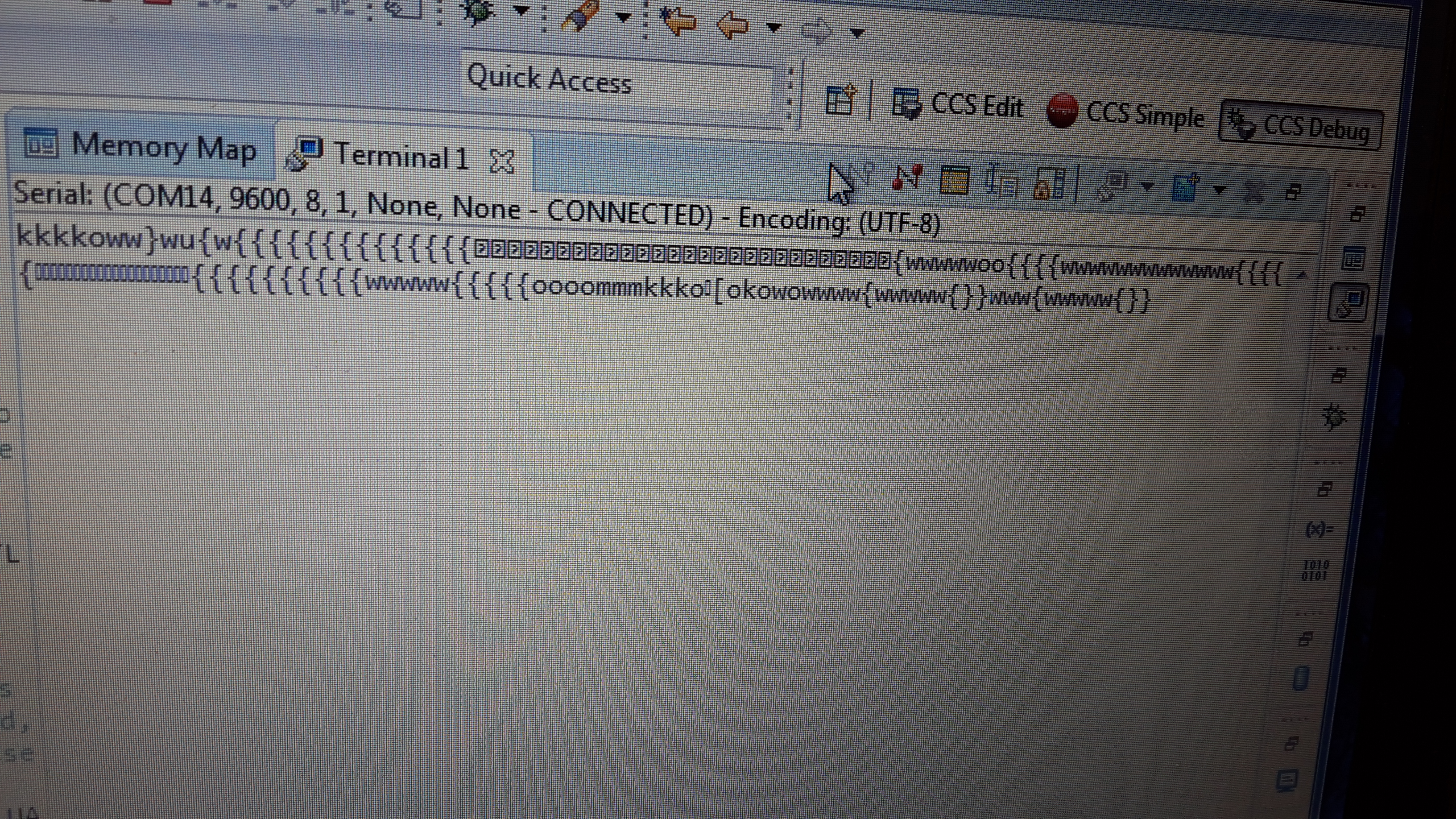

  • Hello Amit,
    1.The COM port shows as Stellaris Virtual Serial Port(COM14).
    2. The Stellaris ICDI driver date displays as 03-08-2012.
    3. The PA0 PA1 pins show no change in voltage when I enter keys on PC, measured it with multimeter, even though the ICDI LED blinks.
    Also when I tested the uart_polled example on another PC it throws unrecognised characters onto the terminal. Im attaching the screenshot for the above mentioned conditions.
  • Hello Monil
    the baud rate is 115200 bps in 8N1 format. Please check the device manager setting and the application on PC setting for the correct baud rate.
