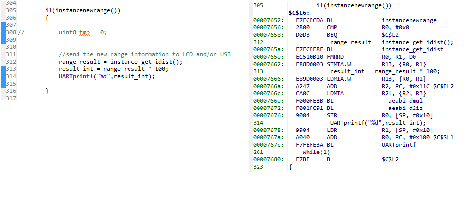

I`m using Tiva TM4C123 Launchpad to control another device via SPI. I can´t use CCS Debugger because in that case the program gets stuck in the beggining (a Sleep loop that uses: while (_clock() - t0  < dt); waiting scheme), I just load the program and I debug with printf´s.
I´m experiencing strange issues (appearing on multiple locations in the code). I´ll name one example.
In this example, the code won´t work unless I define a variable (which I don´t need & use). Here is a screen of a working version (with the declared variable, tmp):
This works ok. Now, if I comment the variable tmp, the code gets stuck in another part, it doesn´t even reach this part, it goes to FaultISR.
I discovered this by turning on the LED when I reach FaultISR (in startup_ccs.c).
I also print the NVIC_FAULT_STAT_R register, which contains 20000 value, which corresponds to NVIC_FAULT_STAT_INVSTAT - Invalid State Usage Fault. This might mean that Branch command has LSB 0 (it should be 1, Thumb instructions). But I also see in the working code that some Branch instructions have LSB 1, some LSB 0 (am I reading that correctly?! ).
Why is NOT defining a useless variable causing the Fault? How can I fix this?
If anyone can suggest anything that might point to solution, please help! I´ll try to do something to have the Debugger useful, but for the time being I can´t use it.
Thank you in advance!
    Without the full project it is difficult to give an exact reason.
    A guess at some possible reasons:
    a) The program has a bug which is overwriting something on the stack, and the useless variable changes where in memory other variables are which hides the bug.
    b) There is insufficient stack space. Does increasing the stack space make the bug go away?

  • b) Well, when I increase it, it goes into FaultISR again, but it doesn´t print the NVIC_FAULT_STAT_R register :/ yeah, something is very wrong with this code :(
    But can it be that compiler does something wrong, that he sometimes produces the wrong Branch instruction? Or something else in a wrong way?
    Should I upload the project? (although you can´t reproduce the error because you need the other device with which I´m communicating)

  • But I don't think that it's the stack, I've tried printing it and it was somewhere in between top and end. Also, I've checked .map file, there is still plenty of SRAM and Flash memory left (it's not like the program is too big). Anyway, I guess I have to get the debugger running somehow, rewrite some code, then it should more clear.

  • It was the stack! Besides changing it under Properties->Build->Linker->Basic Options, I had to change it in .cmd file, and then it worked! Thanks a lot!
