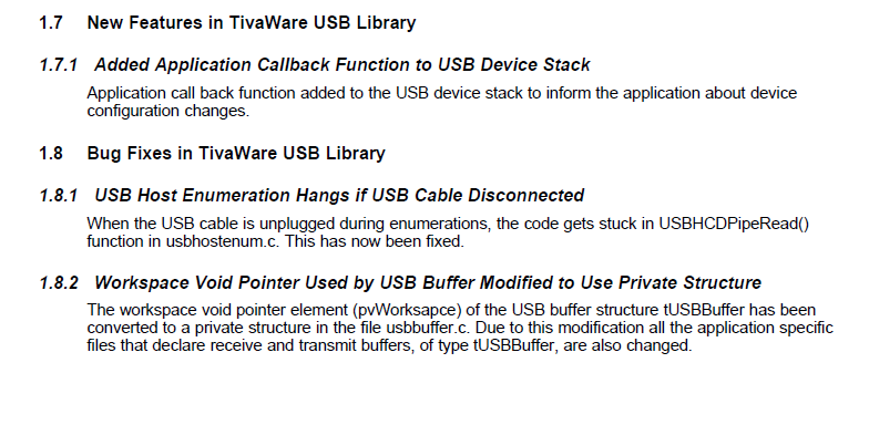

  • Hello Dave,
    The release note for the USB library. I think it is 1.8.2 which may be something that C++ is not handling.
    Amit

  • For those who might experience similar problems, I am posting the final solution here.
    When I upgraded to the new TivaWare library I neglected to update the project's include directories to point to the 2.1.1.71 code. So the code was still compiling using the old definitions for the tUSBBuffer struct. That last entry in the struct used to be a pointer to the private workspace, but with the new library the workspace is contained in the struct itself. But the code was still treating the workspace entry as a pointer, and it happened to point into the g_pui8CDCSerDeviceDescriptor array. So when the private workspace got initialized, the descriptor got corrupted.
    After updating the include files I rebuilt stuff, and it all works now.
