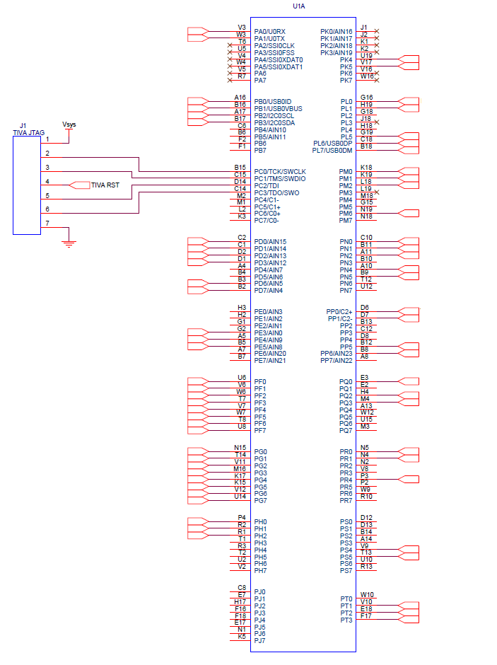

I have 2 custom make PCB that built with brand new tm4c129xnczad. The problem is both boards fail to connect to JTAG by using DK-TM4C123G evaluation board as debugger. I think DK-TM4C123G debugger is working as it can be used to connect to another boards.
The schematic design of the custom board is based on DK-TM4C129X. The exception is no 32.768KHz crystal, Ethernet pins are NC, HIB is NC, Wake pin is pull-high. I believe the above differences should not make the JTAG connection fail. In additional to CCS, I have tried to use Uniflash program, Unlock procedure, slower JTAG clock rate, but do not help.
Any debug idea is welcome.

  • Hello Benson,
    Can you share the schematics of the TM4C129 part on your board?
    Amit
  • Just find something special! Seem related to 25MHz, ROM boot laoder, empty PHY and RBIAS pin...
  • Nicely drawn schematic - good job.
    Here - a few comments:
    a) it is normal/customary to place some capacitor across Reset & ground - minus that "C" your reset may be too brief
    b) critical VRefA+ ties directly to (noisy) VSys.   Note that VRefA+ is brought out separately - so that a better quality voltage (perhaps a precise reference) may be input to VRefA+.   By tieing the (always) noisy VSys - directly to VRefA+ (as your schematic indicates) you have substantially degraded your MCU's Analog performance.
    c) ditto for VRefA- - again this pin should tie to Digital Ground at one point - ideally the "quietest" board ground point.
    d) you've "saved" cost/size of JTAG/SWD pull-up resistors - we find this to so often degrade JTAG signal edges (& levels) - fails miserably at - "Risk-Reward."
    e) power to the MCU board must be proper - and remain such - during any attempt at programming and/or connection.   Is your board supply adequate to task?
  • Benson, what's that JTAG Connector?  I don't recognize it as either the standard 20 pin JTAG connector or the standard ARM Cortex 10 pin connector.  I would suggest staying away from vendor proprietary JTAG connectors.
    Also a series resistor to limit the current when that pin is pulled low by the JTAG. I always use an external supervisory circuit as well.
    Degrade - I've found in practice that this often means does not work.  Always take the most conservative of vendor's evaluation board schematic, ARM's recommendations and vendor's recommendations (and look at the recommendations by the JTAG adapter manufacturers).  It's easy to not populate a resistor, difficult to patch it in later. Resistors are cheap, PCB space for an 0805 resistor is small.
    It's difficult to overemphasize this.
    Agreed, use plentiful decoupling, ceramic caps are cheap.
    Robert

  • Hello Benson,
    That is what my next question was going to be on. The RBIAS pin is missing in schematic...
    Amit
