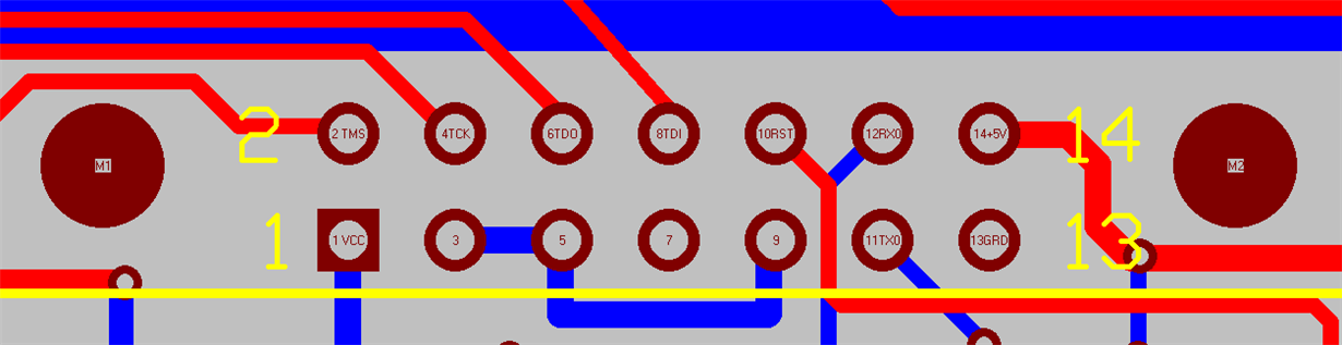

I have been using the JTAG with a small header on my boars to program my Tivas. This method is far from optimum so I started to look at the boot loader.
I discovered there are many types of boot loaders for the Tiva depending on the development system being used.  My goal is to have  a  hardware and software solution that I can drop into my projects to implement the boot loader in various flavors. In my opinion the simplest way to do this is to use the Tx0 and RX0 for the loader and interface on the Tiva side and  a USB to serial adaptor or a Bluetooth to serial interface or a ethernet to serial interface. All these interfaces can reside on a small adaptor board I am going to design. On the software side I want to be able to use LM Flash Programmer and Energia to download the software to my boards.

I will be adding details to this post as I complete   the design. I have already defined a 14 pin header with all the JTAG signals, reset, ground, +3.3V, Tx0 and Rx0. Pins 3,5,9 and 13 will be ground.

  • Hello Claude,
    I am not sure about Energia, but the boot loader guide for TM4C12x devices are clear in terms of expectations of the boot loader that comes wrapped in the TivaWare release. Normally the JTAG debuggers do not have a provision for UART COM pins. It would be good if you can move it out of this header and onto another header.
    Amit
  • Bravo Amit - our small tech group fully supports your directive. (and noted same - but hoped that you'd provide "official" alert.)
    Poster's attempt at "Universal" may not be wise. That's a very high hurdle - desire must (sometimes) match experience, investment, capability...

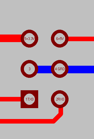

  • Hello Amit, I agree with you, I am mixing a few things, JTAG and serial boot loader.  I did break just the serial to a seperate header.
    Over the weekend I completed the layout of my boot loader interface board, it has a wifi access point/client to serial interface, a USB to serial interface with a FTDI chip and a Bluetooth to serial interface, all selected by dip switches. The JTAG pins are sent to a separate connector. I will be able to use JTAG for development and the boot loader for production. I also did some initial testing and Energia (on my Mac) sees the FDTI serial port, LM Flash Programmer on my Windows PC sees the Bluetooth serial interface. I noticed that LM Flash can use the ICDI interface found on the LaunchPad or a serial UART, I am hopping Energia will also be able to use the UART. I think Energia offers a significant time advantage in simple applications as compared to programming with a C compiler.
