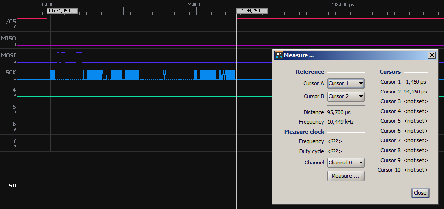

I use Open Bench Logic Sniffer on my laptop PC to spy on the SPI bus. The TiVa evaluation kit runs on my desktop PC.

I try to read the Device ID by sending byte sequence 0x0B , 0x00 on the SPI bus. Page 20 of AD's datasheet shows the following waveforms for reading from a single address:

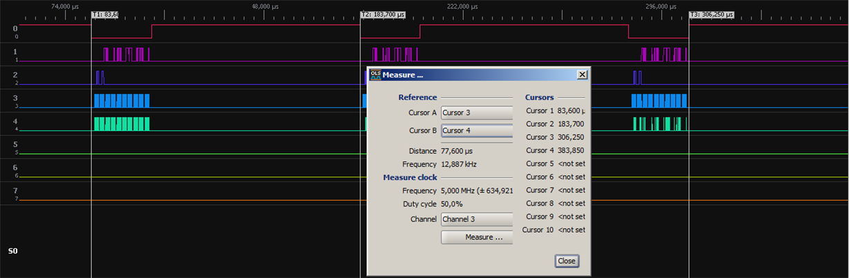

However, what I see on the SPI bus is different:
In InitSPI() function, using:
MAP_SSIAdvModeSet(SSI3_BASE, SSI_ADV_MODE_LEGACY);
results in having the ~CS line going to HIGH between successive byte transfers, which is not the desired case;
and using:
MAP_SSIAdvModeSet(SSI3_BASE, SSI_ADV_MODE_READ_WRITE); MAP_SSIAdvFrameHoldEnable(SSI3_BASE);
results in the above pattern EXCEPT for the end of transmission; ~CS line does not go to HIGH level . MISO line remains silent:

I followed a suggestion here and here to use a GPIO pin as ~CS. Here is what I tried, albeit unsuccessfully:
