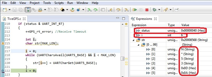

  • Hello Tim
    Now if you read the UARTDR register when RT is asserted what does the Data Read back as?
    Amit

  • Hello Amit:
    As shown in the graphic below, 6 characters were available and read after UART_INT_RT was asserted.
    Evidently, UART_INT_RX was not asserted (status bit 0x00000010 would have been set if so) because there were only 6 bytes, and not 8 or more bytes, residing in the FIFO (default FIFO Level of 4/8 used to trigger on 8 bytes or more of 16).
    Thanks again,
    Tim
