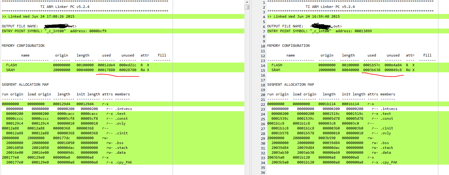

We are using in lwipopts.h a PBUF_POOL_BUFSIZE of 1500 bytes, since we aare using that kind of packets.
However, the RAM size of using LWIP is pretty big for what it does. So if we compare the map files of the same program, with and without LWIP enabled we get:
As a detail:
As you can see, the difference is about 143kBs of SRAM, more than half of the SRAM size!!

  • Ok, one good approach has been to define MEM_SIZE as (18 * 1024) and use only:
    #define MEMP_MEM_MALLOC 1
    and remove the MEM_LIBC_MALLOC define.
    That frees up to 000213b2 of SRAM.
