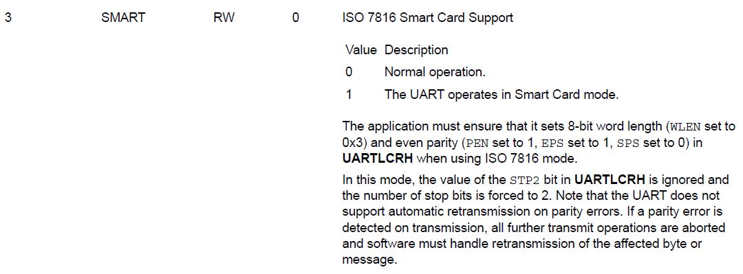

    TM4C12x devices have ISO 7816 Smart Card support as part of the UART interface.
    Amit
  • Indeed Amit is correct - although - the caring & detailed "descriptive user write-up" breaks "new ground" in its completeness.   ........ Or not...
    We found "5 hits" searching MCU manual: "smart card" - below (by far) the longest result (do not blink)
    Poster (and cb1) clearly need to pay far more, "Attention to ever so brief detail."   (below describes "UARTCTL's" bit # 3)

    cb1, if you mean the lack of sufficent application information about how to use UART to implement 7816 - yes, it's a little bit annoying. And this is not the first case of white spots in TI's documentation.
    My friend - the "gaping, gunshot wound" - to my head - better qualifies as, "Little bit annoying!"
    Might, "Lack of sufficient application information" be better stated (really) as, "NO Application Info - whatsoever?"
    No effort was spared in making "smart-card" usage, "Comfortable & Convenient" for client-users...
