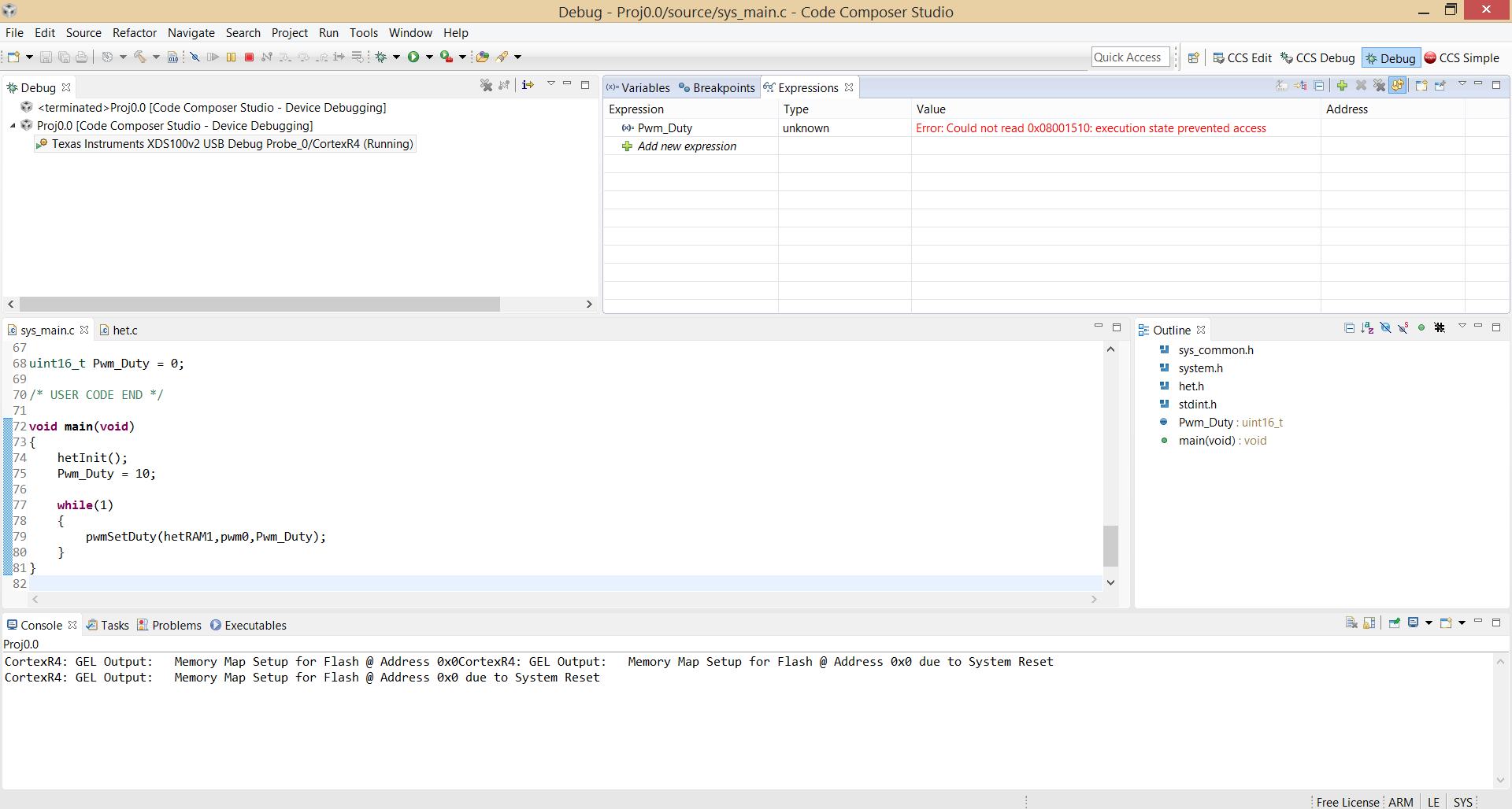

With  the Hercules RM42 when I'm in the Debug mode, the watch expressions don't refresh.
There is a way to solve this problem?
Tanks.
    The only way to refresh a memory location within a debugger on the RM42 MCUs is to use the CPU in debug mode. This means that the CPU will first need to be halted and then the memory locations (including watch expressions) will be refreshed.
    Other RMx MCUs (RM57, RM48, RM46, RM44) do not have this limitation.
