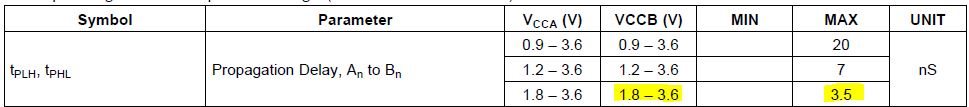

    The propagation delay is caused by level translator SN74AVC2T244. When translating 3.3V logic (MCU) to 1.2V logic.
    Yes the propagation delay is affecting Tx data as well but for that clock is also equally delayed so they are in sync.
    I am just looping back the data by solder shorting Tx with Rx at level translator output.
    I am writing 16-bit data 0xAAAA and receiving the data 0x5555.
    Also by reducing speed to 25MHz, I am able to receive correct data.

  • In the interest of (somewhat) assisting & lightening the workload upon my friend, Amit - the following is presented.    This from poster's Voltage Translator IC's data-sheet:
    What may have been missed - yet may be of critical importance - is the choice of VCCB to tie to the MCU's 3V3 supply.   Then the QSSI device ties to VCCA - which poster lists as 1V2.   Under those conditions - the "middle row" of the above, "Prop. Delay" chart applies.   Yet - if we could some way/how "up" that QSSI device to 1V8 power (from 1V2) - the propagation delay cuts in half!   (i.e. decreases from 7 to 3.5nS.)
    Even more critical is that the 1V2 supply to the QSSI is "stiff" - suffers no drop out - under any conditions!   For instance - if VCCA "drops" to 1.1V the propagation delay may "balloon" to ~20/3 = 6.7 + 7 = 13.7nS!
    I'd expect that use of a QSSI IC which accepts 1V8 rather than 1V2 very well may "meet" your timing specifications.
    And - best of all - if you could find a QSSI device accepting ~3V3 - no translator would be required!

  • Hello Cb1,
    Thanks for the analysis. This makes point that in my application, 1.2V operation can be unstable at high frequency.
    As you explained, level translator is very sensitive at low voltages, minor variation in 1V2 leading to very high amount of delay which is not reliable. And even small board to board power supply variation in production period will create problems in the field.
    So, I am planning to test other low propagation delay translator like LSF0102.
