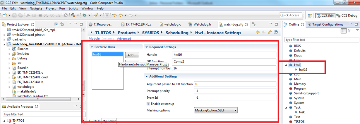

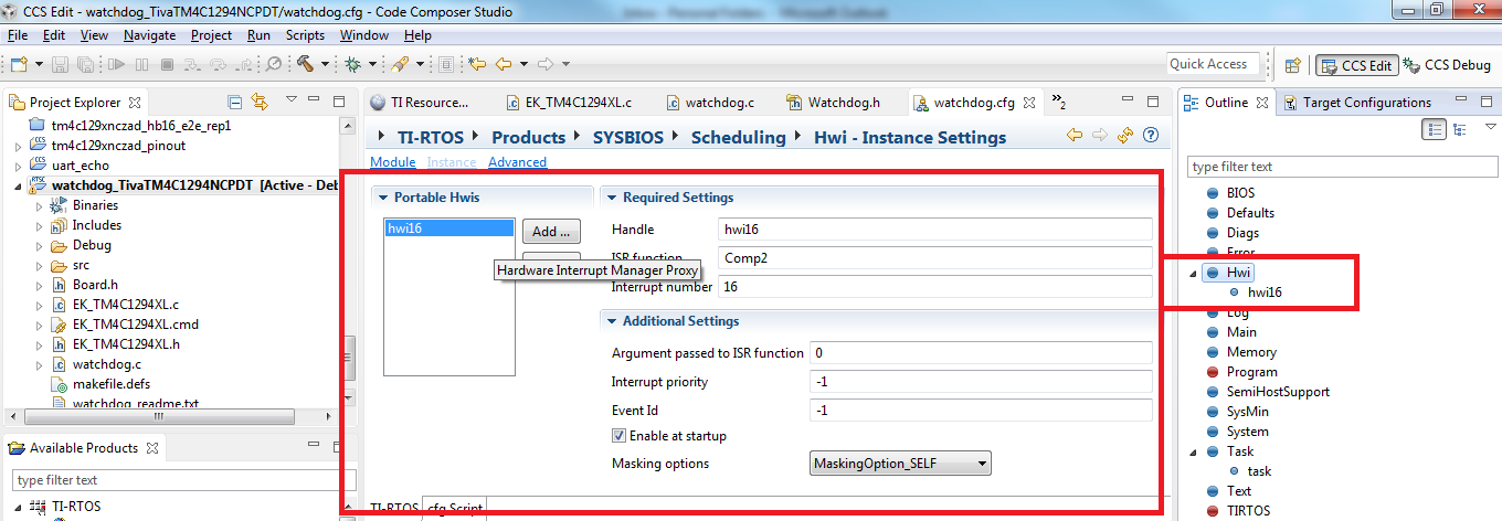

  • Hello Sergio,
    OK. Now I know what the issue is. You are trying to put an interrupt handler in the same section of memory where TI-RTOS puts the interrupt handler table as well.
    Since the TI RTOS (I have a newer version which is different) needs to know the call back function (which in essence is the Interrupt Handler), I would need to find out which function assignment it is so that Int_COMPC2 can be directly assigned.
    Amit
  • Hi Amit
    Wonderful.
    Sergio
  • Hello Sergio,
    Double click the cfg file in TI-RTOS The rest as shown in the image and create a new Hwi handler.
    I would strongly urge you to refer to the documentation on TI-RTOS/SYSBIOS or log a forum post on TI-RTOS if further clarifications are required.
    Amit
  • Hi Amit
    Yes, it worked!
    I used Interrupt number as 43, accordingly with page 115 from TM4C1294 manual.
    I need to fine tune something, because the comp2 interrupt are stopping after some time, but, I can walk again, thank you.
    Sorry to disturb you with a matter from other forum ( TIRTOS ).
    And, what about the C2O output that is not showing 60Hz pulses as expected? In my previous post I explained how I configured this pin. Is that correct for a TIRTOS application? I am afraid that the functions I am using it is not adequate for TIRTOS, as happened with previous issue you solved. Perhaps it is better to address this issue to TIRTOS forum?
    Thanks Amit
    Sergio
