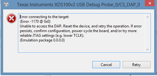

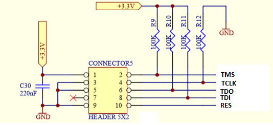

I am new with this controller and jtag interface also.I designed my custom board with TM4C123GH6PM.and I am using TMDSEMU100V2U-ARM: debugger for programming.I am getting error in the following while programming with example code(uart_echo from Tivaware)
and I attached my Jtag interface circuit and I using external crystal 16MHZ and 32 KHZ. and I attached the test condition in the following,

kindly give me some suggestion.
