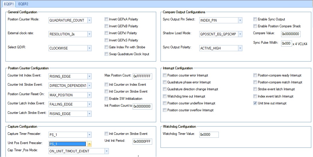

I'm using a rotary encoder (dial switch) with the eQEP module of RM46.
The encoder has A and B 90° phase shifted, and the contacts are hardware debounced.
I started from he HALCoGen example_eqepEdgeCapture.c, and the code reacts on moving the encoder.
I have difficulties getting a reliable value in eqepREG1->QPOSCNT though.
I do get values in the register, but they don't really represent the number of clicks I rotate the encoder.
I'm struggling with what settings to use to get  a representation of the rotation made (left or right in the eQEP eqepREG1->QPOSCNT.
Code (almost identical to the HALCoGen example_eqepEdgeCapture.c example:

If you've used eQEP with a rotary encoder dial, it would be great if you share your experience.
