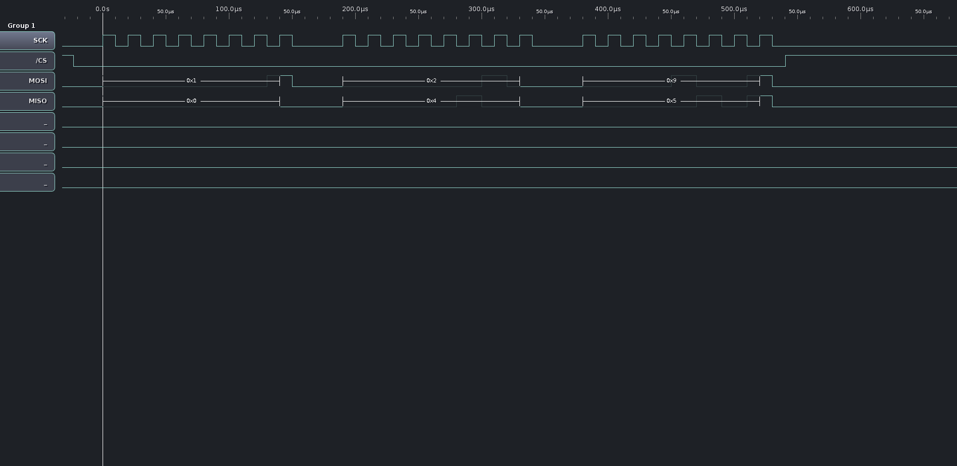

I am using the TIVA TM4C123BH6ZRB and want to send 256*16Bit-data via SSI0 (Master-Mode, Clock=6MHz, DataWidth=16Bit).
Before CS-edge arrives, the Tx-FIFO is filled with valid data (before filling the Tx-FIFO is empty, after filling the Tx-FIFO is full).
But when the Clock begins to run the first 16 bit-data on the bus (via scope) is always NULL. On following transmits all the data is out of allignment...
I tried to fill the FIFO via DMA and also very simple via DataPut  (8x16 Bit), but the result is always the same - first 16 Bit-Value is never transferred,
although it is in the FIFO (first Tx 16Bit-value on bus is always NULL)!
The delay between CS edge and clock-run is > 130 µs!
Could this cause the Problem (timeout)?

  •  Hi Amit,
    thanks for reply.
    This is part of my initialization code. The attached picture shows the transmitted first NULL although the FIFO is full and filled with valid data:

  • Hi Amit,
    the SPI master that communicates with the tiva is an i.MX6 quadCore processor running on Linux.
    The TIVA is SPI slave and has to receive / send data for the exchange via MISO/MOSI.
    Sorry, the Picture is titled incorrect - the red line is unimportant and the blue line Shows the MISO data (data sent from TIVA to i.MX).
    The data that the TIVA receives from the i.MX is handled correctly, but not the Tx data. When the i.MX begins to clock, the first Tx-Transfer from the TIVA is Null!
    I woud be thankful for any kind of idea!
    Tobi

  • Hi Amit,
    thanks for testing your SSI Slave!
    Meanwhile I found the cause why the first sent data was NULL and fixed it. Now it works fine!
    I have to disable the SSI module (clear the SSE bit in the SSICR1 Register) while writing the first 16 bit word into the Tx-FIFO!
    Filling the following FIFO-values can happen with enabled SSI (only the first entry is critical).
    Using the DMA means to write the first entry by Hand while the SSI is disabled and after this the DMA can be enabled
    to to the rest...

  • I can confirm Tobi's findings. The attached code is a basic test showing the problem: it exchanges 3 bytes between SSI2 (master) and SSI3 (slave) (to be used with the booster pack sockets of an ek-tm4c1294xl). In the form posted everything is fine because SSIEnable(SSI3_BASE); is called within the send for loop after the first slave to master byte was put into the FIFO. However, if you enable SSI3 before the loop (commented out) the first put is ignored and a 0 is transmitted on MISO. I have also confirmed this with a logic analyzer and have attached screenshots of both cases. The TM4C1294NCPDT used is revision 2 AFAIK but I could test this on revision 3 as well if need be.

    SSI3 disabled before 1. put:
    SSI3 enabled during 1. put:
