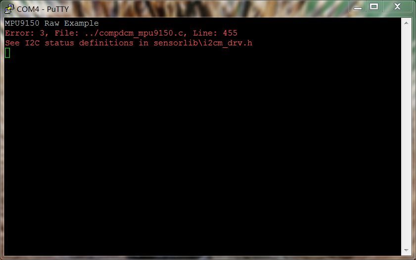

MPU9150 Example Error Arbitration Lost
I'm trying to get my hands on the MPU9150 9-axis motion sensor using TM4C123G. I imported the compdcm_mpu9150 example project but ends up with some problems. After I2C initialization and before MPU9150 initialization, the serial monitor (consistently) displays an error message:
I searched and found the error3 to be I2CM_STATUS_ARB_LOST - master arbitration lost. I have been reading about possible causes of I2C arbitration lost, some of the reasons being that the slave is pulling the SDA low so that master could not initiate a new transfer. One of the most common solution is to toggle the SCL and eventually the slave will release SDA. In an attempt to solve the problem, I added the following code segment before MPU9150Init (MPU9150Init is where the I2C line hang): (PD0-SCL, PD1-SDA, PB5-used for measuring logic level of SDA)

    Thank you for your suggestion. Upon trying your suggestion and doing a few more experiment, I found the intrinsic problem, the PD1 port on my launch pad does not seem to work properly - it drains the 3.3v pull up and refuse to be pulled up even if I enable a pull up on that pin.
    After switching to I2C2 module, both SDA and SCL lines are pulled up properly now. Thank you for your effort in helping me resolve this problem.
