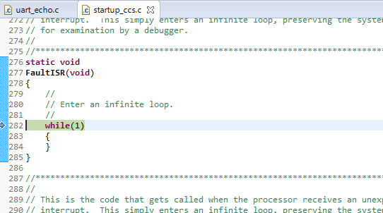

I am working with TM4C123GH6PM controller, I am new to this controller. I configured one uart 3 for serial communication  with RX interrupt and that is working fine. And I configured one more UART 4 for RS485 communication with RX interrupt and RS485 enable  is GPIO D0 pin.
1) data trasmit and receive some time working properly through UART 4. after that, control goes to Fault interrupt loop.
2) and also some times controller reset, after that interrupt is not working.
I donot know why this is happened.Kindly suggest me ragarding this.

    I am configure uart 0, uart 3, uart 4 and GPIO as below. uart 0 and uart 3 is used for RS232 communication and Uart 4 for RS485 communication. And I used RS485 enable pin GPIO D-pin0, and application is that every 5 sec I send request using RS485 to the device. response data is received from the interrupt. that code is attached here.
    problem is that,
    1) after 3 or 4 time only, data read properly after that it will go to fault interrupt loop.
    2) some time error --- No source available for "SysCtlDelay()
    3) some time error --  No source available at 0x0.
    configuration:

  • Hello Sathish,
    There is nothing obvious wrong with the code. When the debugger mentions no source code for SysCtlDelay it is because you are using the driverlib version of SysCtlDelay for which the source code is not there in the precompiled version. You can get rid of that by recompiling the driverlib and using the new local copy,
    When it goes to the fault handler, did you check what the FAULTSTAT shows up? Did you change the Stack Size?
    Amit
  • Hi Amit,
    I already included SysCtl.c and SysCtl.h into my project. and I set my stack size is 1024 and heap size is 320. but same problem is coming as I mentioned above.
    And 1) One thing, I noted that when I continuously sending data to the uart , that time control goes to the fault interrupt.
    2) some time SysCtlDelay() is not working properly.
    3) some times, controller reset is happened.
    kindly suggest me regarding these problem
    Sathish.

    It is quite normal what happens here with your code. Look at this line in your interrupt routine:
    RS485_Rx_Buf[RS485_BufLen++] = ROM_UARTCharGetNonBlocking(UART4_BASE);
    The question: what is the length of your receiving buffer? it overflows after a number of chars, resulting in fault interrupt.
    You should use defensive programming - test first the length of receiving buffer and if at the limit either do not do anything , resulting in lost chars, either use a circular buffer - you have such bundle of routines in /utils/ringbuf.c file. (or use UARTStdio).
    Petrei
  • hi,
    @ Petrei , RS485_Rx_Buf[RS485_BufLen++] -- here, I declared unsigned char RS485_Rx_Buf[512] and RS485_BufLen declared as unsigned int.
    And when I send a request to the the device, I put RS485_BufLen as 0, and I received the max byte is 50. so I thought that there is no problem in the RS485_Rx_Buf and RS485_BufLen that means buffer overflow or Buffer length out of range.
    kindly suggest me regarding this, If may be I wrong.
    Thanks for your valuable response.
    Sathish.
    OK, your precautions about buffer length are good, although you may shorten that if only 50 bytes ever received.
    Some more things to check:
    a) as cb1 told you, you must remove the 0 ohm resistor found on PD0, since this means collision with ICDI chip;
    b) nothing is specified about the length of UART's FIFO - you may modify it if needed. Keep in mind that many UARTs working with the same baud rate could be problematic if interrupts are simultaneous - this may happen since you have long delays in both receiving and sending routines. Try to remove them, or keep a very short delay - a said 2 cycle delay on pin level change is shorter than function return from stack, so including such delay when using library functions is not needed (I do not use such...), but needed when direct register addressing, which is not your case.
    c) TI has an application note about managing hardware faults - grab that, read it, understand it an use it every time when you have such problems.
    d) try to analyze more the behavior of your code - when it blocks - how many characters are  sent or received -
    Petrei

  • Hello Sathish
    I mentioned the FAULTSTAT register. Please open the data sheet and search for the same, and you will see what it's address is. Petrei has mentioned something better, an application note on www.ti.com (I expect you to search the same)
    Consider a scenario that the RS485_BufLen does not get to 0. Instead put a SW guard band stating that if the value is >49 then it will remain at 49.
    Amit
