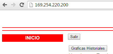

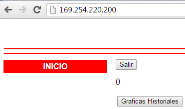

Hi fellows I’m working with a ek-tm4c1294l board, with the enet_lwip example. I’m having problems showing some data when I load a webpage. To achieve this I’m using HTTP requests in javascript, and the webpage is programmed in HTML.
I’m trying to show an integer variable which I get from the board. The strange fact is that sometimes I see the variable and sometimes not, in a kind of random way , as you can see in the following images, respectively:
