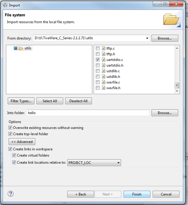

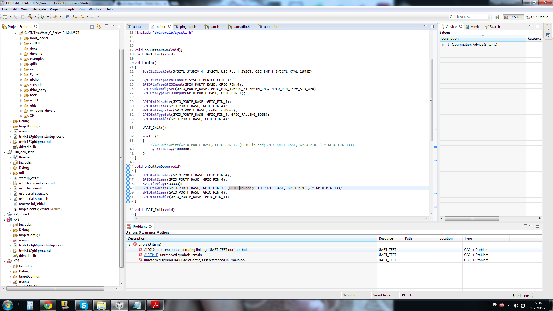

    UARTStdioConfig(0, 115200, 16000000); //here I get the error, when I comment this line the error disapears
And these are the errors reported:
When I add the file uartstdio.c into the project directory, the error is gone. But the compiler must search for this file as it does for the others. I don't understand what is wrong. Any help would be much appreciated.
