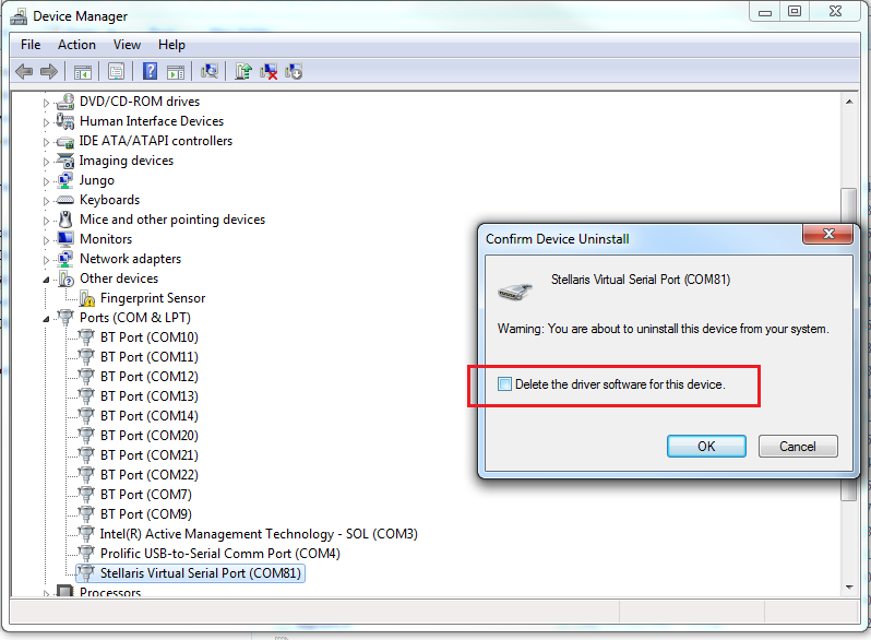

I'd like to get the usb_dev_cserial example working on the ek-tm4c1294xl board but I'm having trouble getting the USB listed as a virtual com. Currently, when running the dev_cserial example, I see the USB listed as a USB Composite Device. The device status states "This Device cannot start. (Code 10) {Operation Failed} The requested operation was unsuccessful."
Below is a screenshot of how the device shows up. I've manually tried to update the driver by pointing it to the C:\ti\TivaWare_C_Series-2.1.1.71\windows_drivers folder and selecting the cserial.inf but I get an error message stating "The folder you specified doesn't contain a compatible software driver for your device. If the folder..."
I also ran the TI RTOS version of this example, usb_dev_serial, and that one worked as soon as I pointed it to the same windows_drivers folder I tried earlier. Screen capture below.
The usb_dev_bulk example is working correctly but I need a virtual port. Any help on either fixing the driver issue with the cserial example or adding a virtual com to the bulk example would be greatly appreciated.
