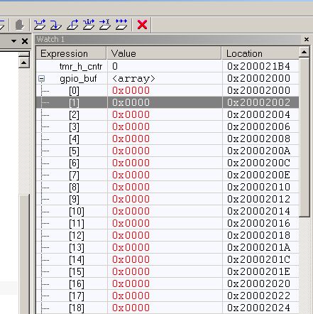

  • I'm sorry for the involuntary fraud, it was mistake in the name of the processor. My device's name is LX4F120H5QRF. It's old part so I meant TM4C1233H6PM as the analog, but I've done a mistake in the name. I use Stellaris Library for the chip supporting which may consist different definitions like TIMER_CFG_32_BIT_PER. This device is exactly Cortex-M4 processor so I put my question in this thread.
    Maybe I badly described my problem. As I see DMA works (values in gpio_buf change its state during working), but works incorrectly. The problem is values that DMA stores in gpio_buf doesn't match real signals on controller's pins. It seems like DMA reads from the wrong register. There are some screenshots from my IDE:
    1) State of gpio_buf before timer_enable();
    2) State of gpio_buf after timer_enable();
    As you can see it fills so I'm sure that DMA works.
    3) State of the GPIOD data register (source of DMA transactions):
    As you can see the one pin has the high level so it's impossible to get a value equal to 0 after the DMA transaction.
    I expect that I'll get a value 0x0004 in my buffer, but it isn't so. Amit, could you check does it work properly on your platform?
  • Hello Tankist,
    The GPIO module uses bit banded scheme to read pins (details in the data sheet). The define GPIO_O_DATA is 0x0 and this will cause it to read 0x0 always even though the GPIODDATA shows 0x4. Instead of using GPIO_O_DATA in the UDMA source buffer use the offset 0x3FC
    uDMAChannelTransferSet(DMA_CHANNEL | UDMA_PRI_SELECT,
    UDMA_MODE_BASIC, // linear filling
    (void *)(GPIO_PORTD_BASE + 0x3FC), // GPIOD data register
    gpio_buf, // my buffer
    DMA_BUF_SIZE); // buffer size
    I will file a bug for this correction of GPIO_O_DATA to be 0x3FC.
    Amit
  • Amit, thank you very much! Now it works well.
