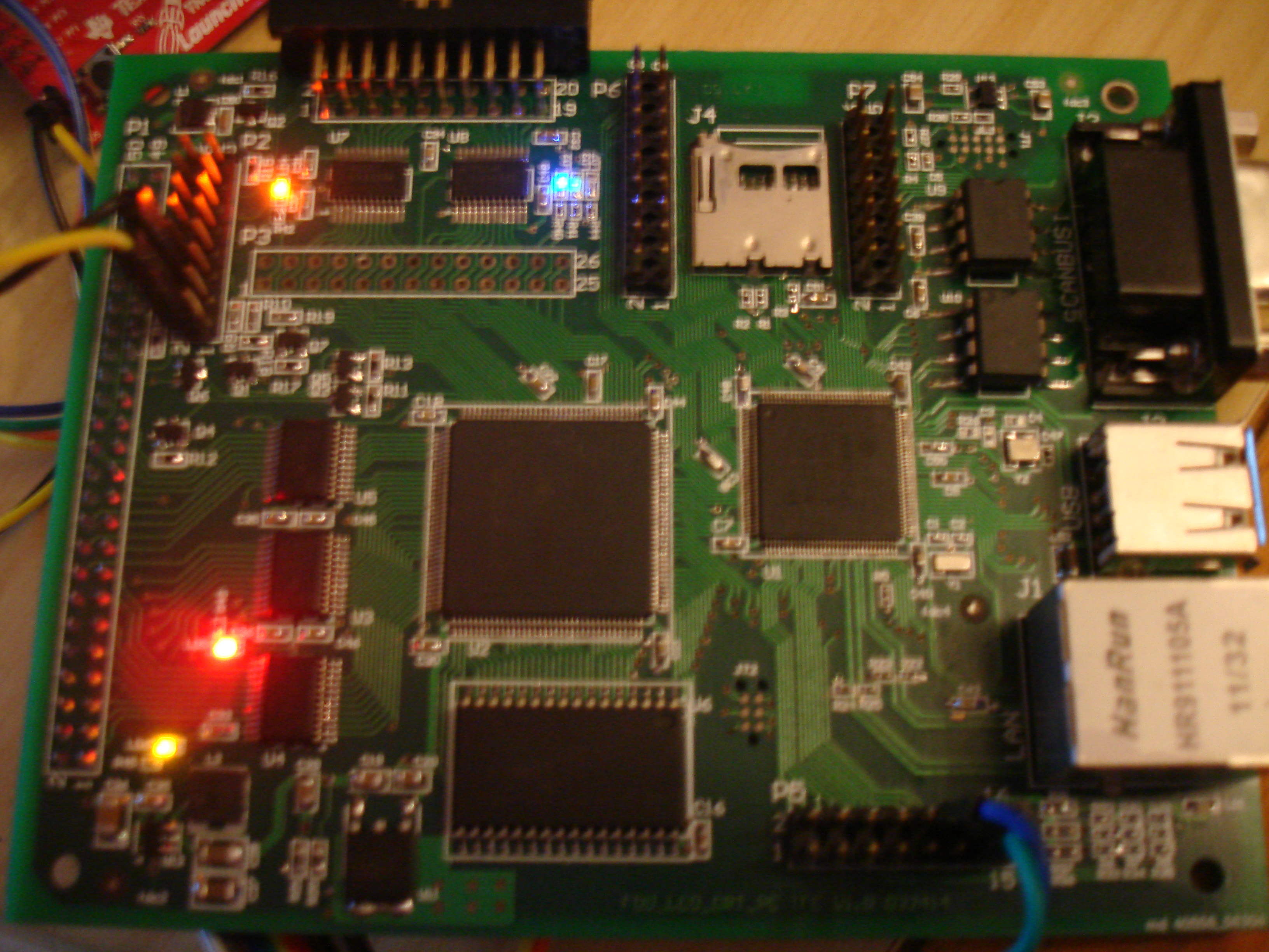

No VDDC is present on my Tm4c1294NCPD Board
 Device on my custom board never connected again to Network, so I checked MAC address with Flash utilities, I set again then I try'd debugging, processor debugger started then at first step reached ISR fault... No way to step, so I measured VCC and is 3.3V VDDC is zero. Oscillator is running (not an xtal a 3.3V 25MHz oscillator.
 VDDC line is not shorted, measuring with a multimeter 4K impedance is present and a 0.5V can be imposed injecting  very small current in the order of few tens uAmp.
 Processor is an Early XM4C1294 got at beginning of 2014. I just own some more early sample (c129ncdp) dated 2013 but I don't risk mount them.
 Is processor to be reworked or can try some trick? Can I supply VDDC core from external? If yes some core low voltages are ready on FPGA too.
 Processor is warm and nothing than debug was done to try isolate network fault.
 I am migrating away from TI processors due to worst policy but this board costed me too much and I need it to finish startup.

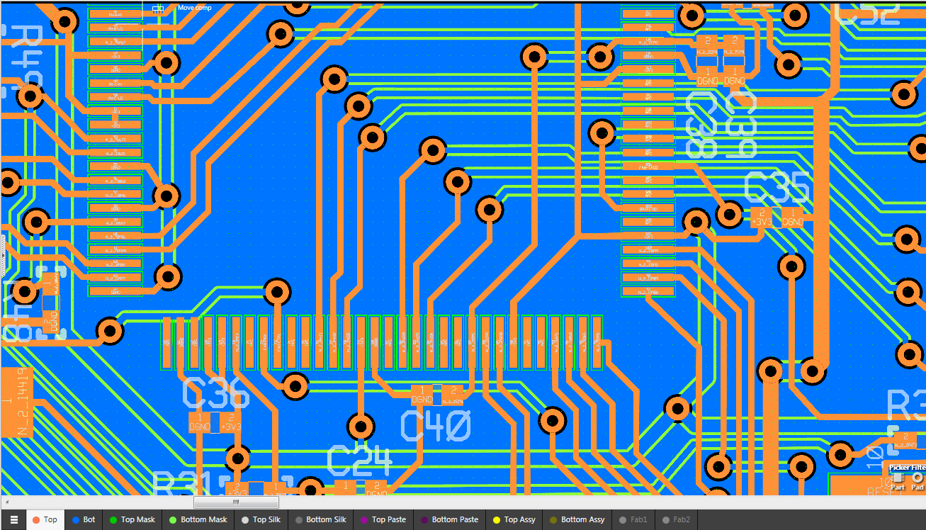

     This is layout, connection is on ground plane and is between the two 3.3V planes, impedance is low and capacitor as you can see are very close to processor.

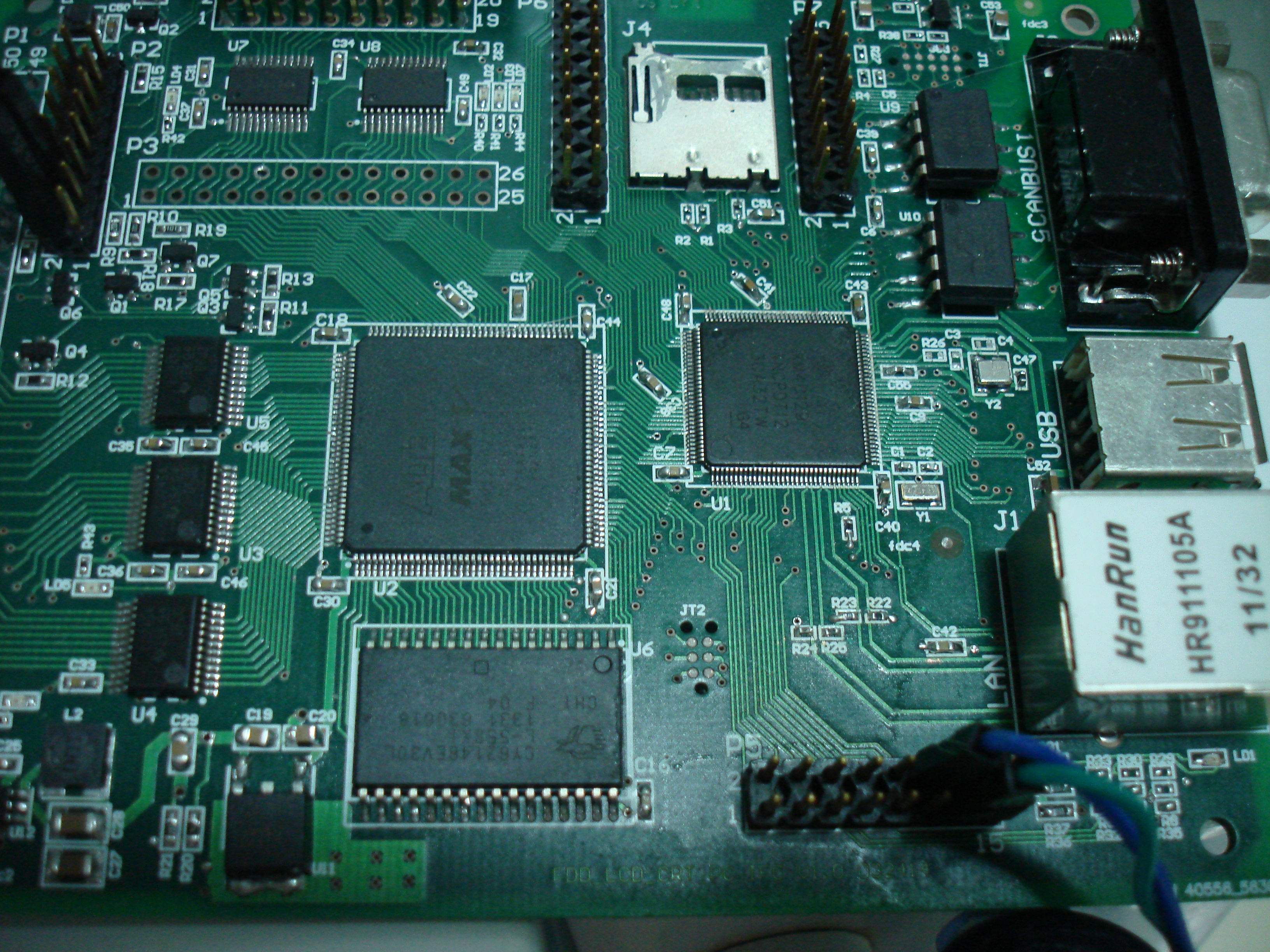

    and here the board powered, power led are all lit, blu and green FPGA activity are on but all MCU LED are off.

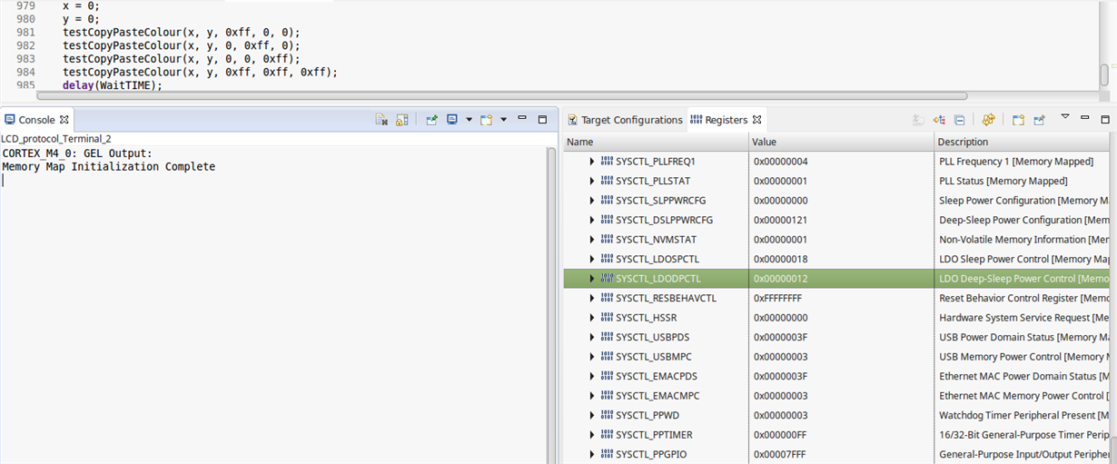

    finally the screen of register showing LDO status just after flashing, not sure flashing is really succesful

     Hi Amit, are you referring SYSCTL#16? this say
    SYSCTL#16 On-Chip LDO may not Start Properly During Power Up
     My device is forever down, voltage is forever near zero -> 2mV
    I rework device when it arrive, I don't wish build another board as suggested by CB1 so I just try cure this and see what happen.

     Start layer color and position 1 (Solder) red 2 Ground planes (Brown) 3 Power plane (Cyan) split on left where +5 section is present and 4 soldering side blu.
     VDDC was buried between red and cyan power planes to a path near I supposed it return back to capacitor. This is the less inductive path but remember radiation is another thing. Dont' confuse switching with RF!!! On switch you have to avoid moving application of magnetic field vector, this way is EM so problem come from antennae or radiating planes. A solid plane radiate more than a split slotted one. If you are not familiar with S parameter and RF it is difficult to understand why a plane is worst than a transmission line pair.

  • Hi Roberto,
    This print show 2 layer PCB with integrated GND plane (blue). Cost of same PBC doubles with 4 layer integral GND plane and VDD rail layers.
    Trade off: AGND(blue) encapsulates most all very long runs of MPU signals on bottom PCB. The bright lime green (.1778mm) air gap bottom solder mask. Long ago  a (2 layer integral GND plane) before CAD (auto copper keep out) it was impossible to encapsulate signals in AGND without later having production solder bridges etc... Example of RF perpendicular plus axial vector avoidance technique ,  the top surface signals (orange) have a parallel copper shield (blue) bottom of PCB. That encapsulate most but not all signal paths parallel to the RF radiation plane axis and top surface traces (orange) then have an axial GP below them. That versus the (high cost) perpendicular axial vector RF avoidant multi layer PCB concept.
    Seeming that RF(you mention PLL 480Mhz) tends to escape along the edges of copper traces more than from the center. Perhaps the reason you mention AGND plane is often perforated in ANSI cross hatch. Thanks for reminder, solid versus cross hatching makes a less effective RF sink antenna.
    Example: Basically PCB bottom side is the Analog GP~~~~

  • Hello Roberto,
    The Section on Power Control in System Control Chapter ahs a note that "VDDA must be supplied with a voltage that meets the specification in Table.... or the microcontroller does not function properly..." and then giving further detail that it is required for the clock circuitry
