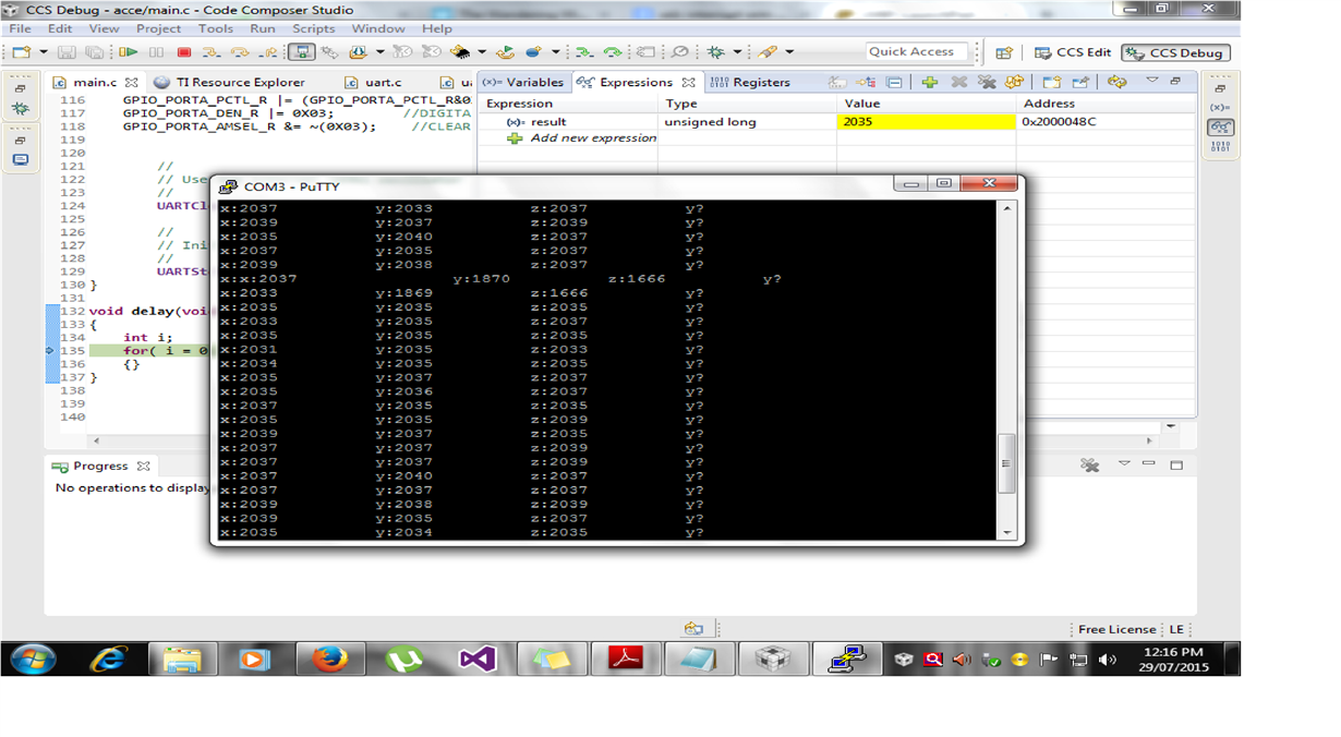

i`ve been trying to interface an accelerometre using adc interrupts,,,all is well until the 3rd iteration of the 3-axis values.It outputs me the  same values of all the three axis on putty after the 2nd iteration ..... let me post a screen shot of what exactly happens..plz observe the iteration carefully
this is my main....
void main()
    k = 0;
    portf();
    adc();
    ConfigureUART();
    ADC0_ACTSS_R &= ~(ADC_ACTSS_ASEN1);    //DISABLE SS1
    ADC0_EMUX_R |= 0;                     //SOFTWARE TRIGGER
    ADC0_SSMUX1_R |=0X0210;              //1ST STEP A0(E3) : 2ND STEP A1(E2) : 3RD STEP A2(E1)
    ADC0_SSCTL1_R |= (ADC_SSCTL1_END2|ADC_SSCTL1_IE0|ADC_SSCTL1_IE1|ADC_SSCTL1_IE2) ;   //3RD SAMPLE IS END OF SEQUENCE
    ADC0_ACTSS_R |=(ADC_ACTSS_ASEN1);  //ENABLE
    while(1)
        if(((k%3) == 0) && (k>0))
            k = 0;
            UARTprintf("y?\t    ");
            delay();
            UARTprintf("\n");
        ADC0_PSSI_R = 0x0002;
        while((ADC0_RIS_R&0x02)==0){};
        result = ADC0_SSFIFO1_R;
        ADC0_ISC_R = 0x0002;
        if(k == 0){UARTprintf("x:");}
        if(k == 1){UARTprintf("y:");}
        if(k == 2){UARTprintf("z:");}
        delay();
        delay();
        delay();
        UARTprintf("%d ",result);UARTprintf("\t");
        UARTprintf("\t");
        k++;
        ADC0_SSFIFO1_R = 0;
