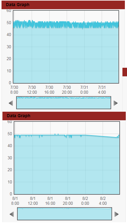

    BTW: The addition of 33uf capacitor on both USB ports stabilized the ADC temperature readout is very steady 49-50c versus being all over the place. Note worthy since adding 33uf caps the EMAC0 symptoms have changed. The caps seem to have helped to arrest 99525, 98496 codes, the results now have been more often a TCP error.
  • Hello BP101,
    Thanks for presenting the facts. In the case that 33uF have stabilized the ADC temp readout (no details on what the temp reading was before the addition of the caps) and the fact the codes 99525 and 98496 are no longer coming, can we go and see what the source of the MPU reset was. May be there is a BOR condition that is being triggered.
    Also in case the issue is still there and reproducable can the device be submitted for FA for any damage that may have been caused by prolonged failures that you have been seeing.

    Captured the ADC temperature readings from IOT Cloud.  Quite a difference in the temperature readings taken before Friday morning when the 33uf caps were installed on the USB ports. There must have been some small amount of supply ripple getting into the USB0VBus. Never actually checked for ripple with the scope rather added 33uf/.1uf caps as a preventive measure. True RMS DMV shows no AC ripple down to .000mv. Recently checked all electrolytic in the 550 Watt PC power supply output, +5vdc 2- 2200uf in parallel each measured roughly 2300uf.
  • Hello BP101,
    The ADC temp sensor may be getting coupled to the USB0VBUS supply ripple. Note that Temp Sense accuracy as mentioned in the data sheet is under lab char conditons
    Amit
  • Hi Amit,
    Datasheet ADC electrical specification also states 2.2uf is minimum value. We plan to use 330 Ohm series resistor to 3v3 , SMT .05m ferrite bead and 3.3uf ceramic for the ADC VREF source.
    Past experience has proven a series resistor adds current ripple rejection and circuit isolation. ADC VREF Isolation should come in handy should 12.5Khz PWM ripple be riding in/on the DC.
