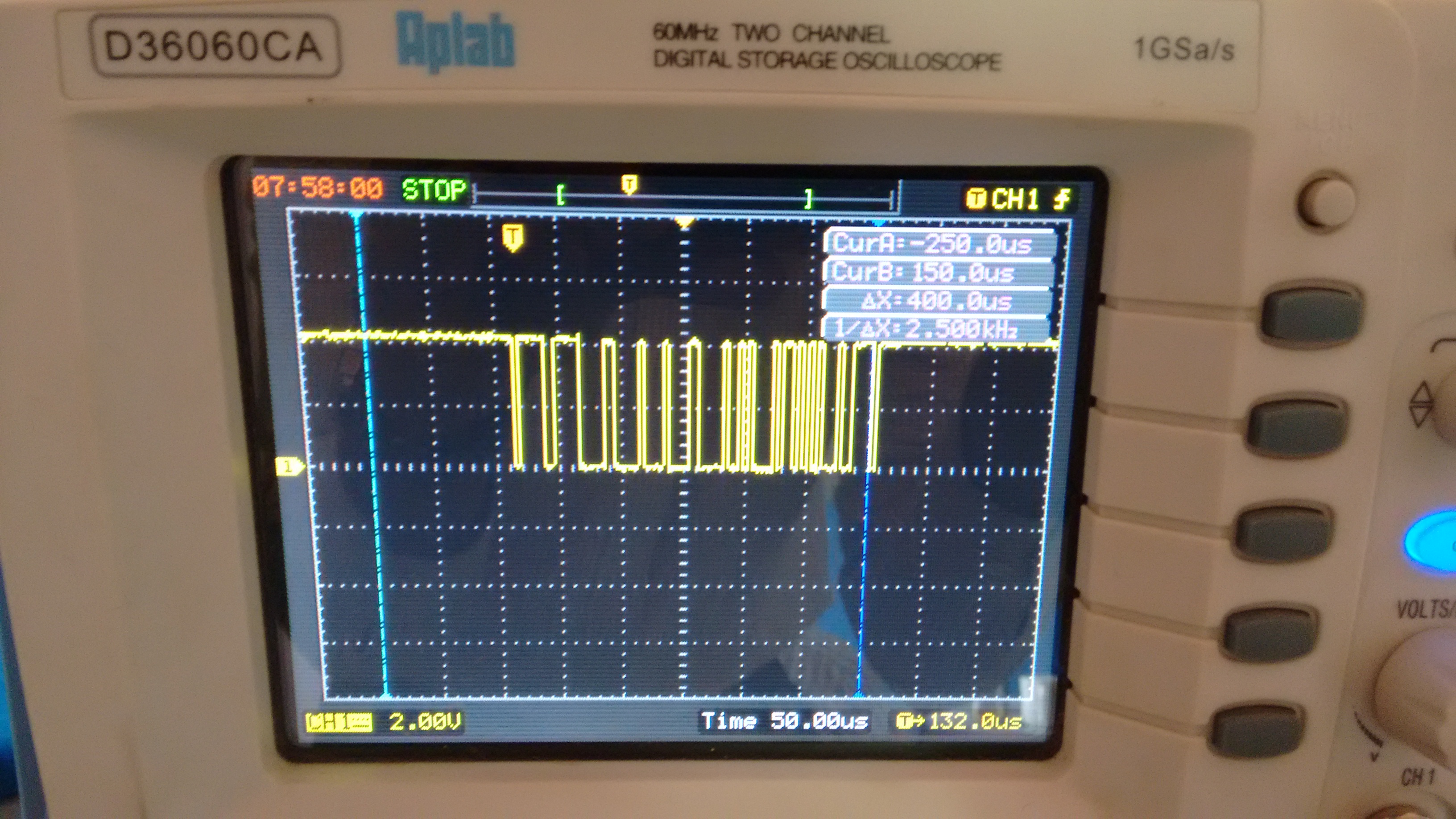

hi
we are developing a product based on TIVA controller and trying to use CAN but we used example code to test it but now we are trying to send the CAN message data frame of size 8. When Iwecapture the CAN data at the CAN simulator we can see only Message ID,length and one byte For example In the code atttached I am planning to send 0x7DF 8 1 C C C
0 0 0 0.
But what appears at the other side is only 0x7DF 8 1 please help us to resolve this issue asap
