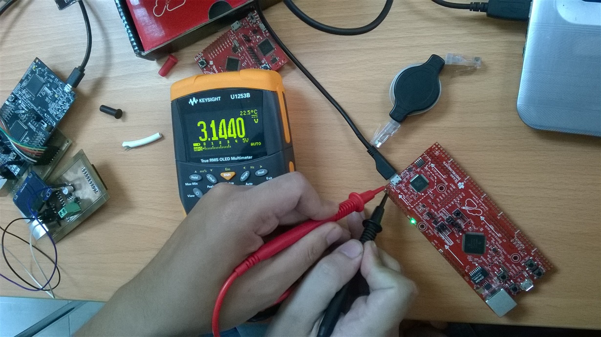

Is it safe for the TM4C1294 Connected Launchpad to be powered directly from the 5V pin using a boosterpack after switching the power select jumper to "Booster pack"?
I recently designed a boosterpack with a 5V-fixed AMS1117 so that I can power my Connected Launchpad from an external electrical source, with the 5 V output of the AMS1117 connected straight to the 5V pin of the launchpad. I noticed by doing that, I bypass the current limiter TPS2052B and feed the 5V directly to the TPS7373, which I assume is a 3.3V regulator. After switching the jumper to Boosterpack the launchpad runs and can be programmed from the USB debug interface.
After 2 days I decided to disconnect the boosterpack from the launchpad to work on something else. After switching the Jumper back to ICDI and connecting the USB cable, I found out that the 5V pin now gives only a reading of about 3.1V. I assume the TPS2052B has died (since the launchpad still works with external 5V source connected to its 5V pin) and suspect that it is my action of connecting the 5V straight to the pin that damaged it.
So is connecting a 5V regulated source to the 5V pin on the launchpad for power recommended, or should I provide a 3.3V source to the 3.3V pin?
