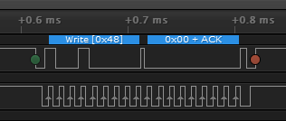

Here's what a logic capture of these steps looks like:
As far as I can tell, both of these commands are working as expected, so I won't post the I2C code that the TMP275 driver is calling.

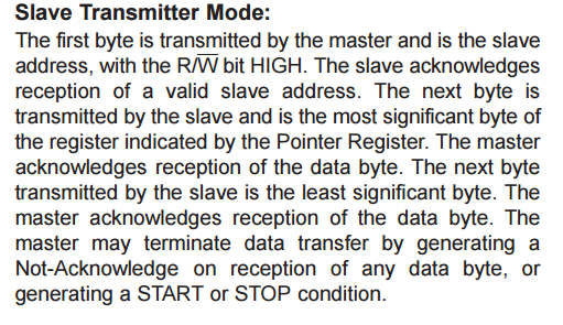

Here's the relevant section of the TMP275, at least from my understanding:
Looking at the logic capture, it's pretty clear what's going wrong. The TMP275 correctly sends back the MSB of the temperature register (0x1C00 works out to 28C, which is roughly the ambient temperature where I am), but the TM4C123 sends a NAK after the first byte, ending the transaction without receiving the second byte from the TMP275.
