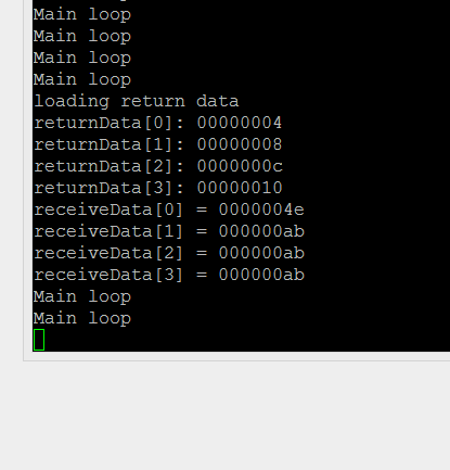

  • All right, I do see where it says that about continuous transfers requiring the CPHA bit to be set. So, I did that, and now the slave reads the master correctly.
    But there is still an issue. The slave is not reading and writing on the same clock edge, which is messing up the transfer from slave to master.
    There is a screenshot below of the the slave UART output. It is trying to return the data in returnData, which is [0x04, 0x08, 0x0C, 0x010] in hex.The master is sending [0x4E, 0xAB, 0xAB, 0xAB], and the slave is reading this correctly, as you can see.

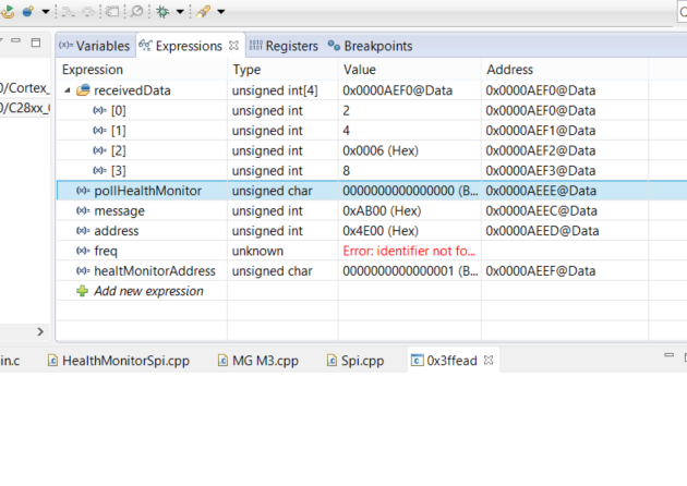

    The image below is the Expressions view while debugging on a F28M35 configured as a SPI master. You can see the receivedData array is off by a factor of two from what it should be. But see the scope image below, too please.

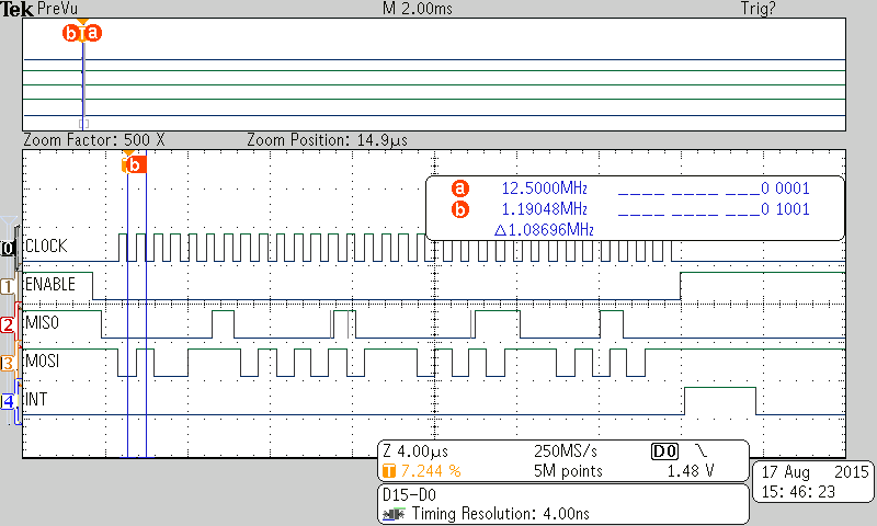

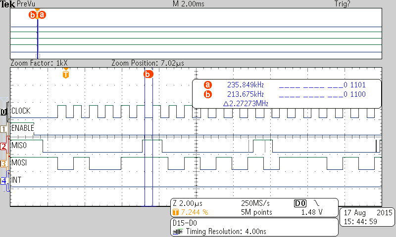

    The two scope images pretty clearly show how the slave is reading on the falling edge (as it should be). I have CPHA = 1 in my slave configuration on the tiva. But it is writing on the rising edge. I don't see any option for opposing edge read and writes in the data sheet. Have you seen this behaviour by any chance? I also tried configuring both slave and master for a falling edge clock, with CPHA=1, but it was the same problem. Thanks if you can help.
  • Hello Erik,
    As mentioned in the data sheet, the Output is propagated on the Rising edge and Input is captured on the falling edge in Mode-1.
    Amit

  • Good morning Amit, I need more clarification, because what I am seeing on the scope is not what is described by you or the datasheet. I assume "data is then captured on the falling edge" means input data is sampled and shouldn't be changing on the rising edge (this is what I see). Then, I also am assuming data is "propagated on the rising edges of the SSInClk signal" means data changes, or has an edge, on the rising edge (this is not what I see on the MISO line on the scope screen shot I provided). This interpretation matches the data sheet waveforms of figure 15-6. However, it is not what I see. What I see is the slave propagating 180 degrees out of phase with the master. What I see is falling edges on MOSI and rising edges on MISO. What I see does not match the waveforms or the language of the data sheet. Do you agree?
  • Hello Erik,
    The propagation of a signal has delay due to the buffers and the IO. That is why it would have been launched on the rising edge of the clock which is also delayed and gives the impression that it is 180 degree out of phase.
