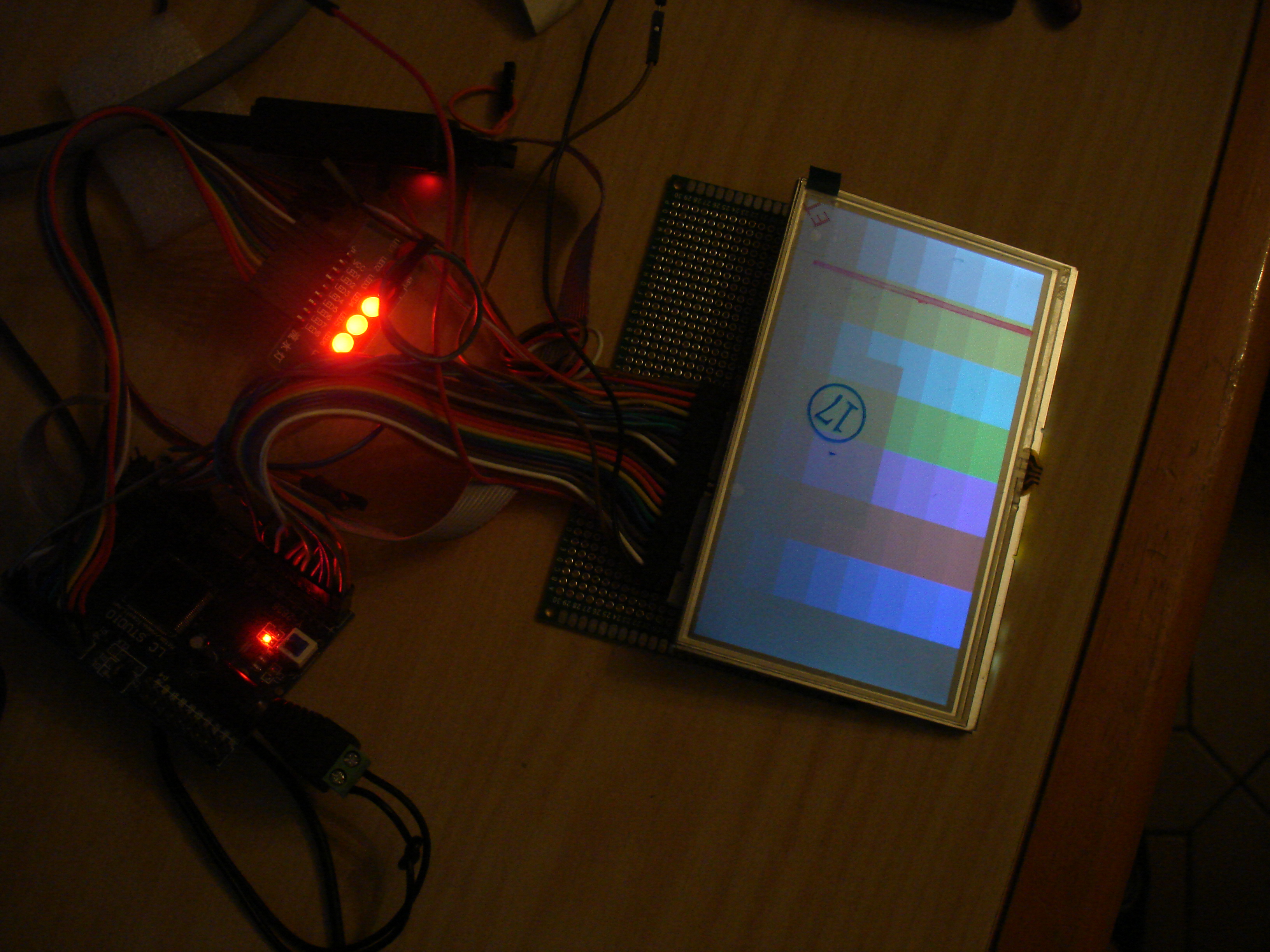

     So final solution was VHDL on FPGA, here detail of test bed on a cheap few US$ maxV 240 and evaluation of TM4c129 in front of 256 1mm spaced FPGA casing. 100uM lines are not a trouble but cost is not affordable other than reliability of this on a mechanical machinery.
    and here is the comparison of 256 balls  1mm spaced fpga with 212 balls ultra thin tm4c129, this was the worst past issue, now I got a workhorse where all code and IPcore are on same chip.

  • Thanks to all of you.
    I was thinking use an external SD memory as a main memory for the raster image and I'd like to create my own TFT driver for 4.3'' 480x272 TFT with uDMA with either the tm4c123 Launchpad or the tm4c1294 Connected Launchpad. Like some of you said, the TM4C129x has an LCD controller inside of it, but the TM4C1294GXL (Connected Launchpad) doesn't have any LCD controller inside, so I'd like to do a dedicate LCD controller with it.
    So do you think that it isn't possible with them (tm4c123 and tm4c1294)?
